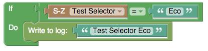

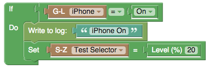

Post by cgaudry »
Sorry for the delay but it is :
if (devicechanged['MyDeviceName'] == 'On') then
        commandArray['Test Selector']='Set Level: 20'
return commandArray
Where 20 is the level value, not the level name.
if (devicechanged['Test Selector''] == 'Level3') then
        commandArray['MyDeviceName']='Off'
return commandArray
Where Level3 is a level name.

It is the same in blockly :
