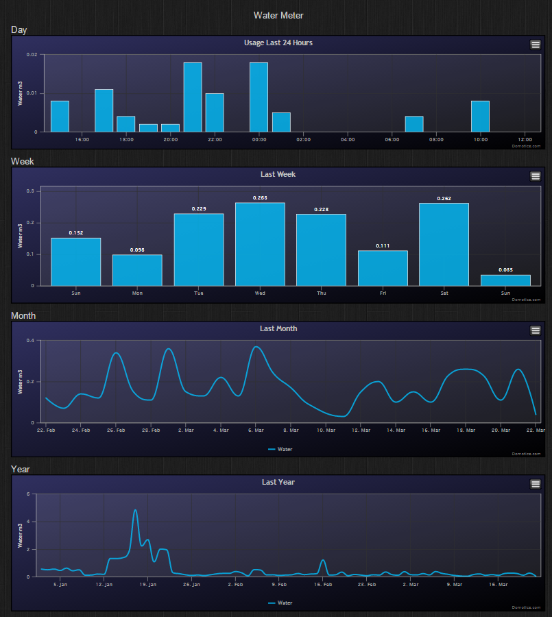

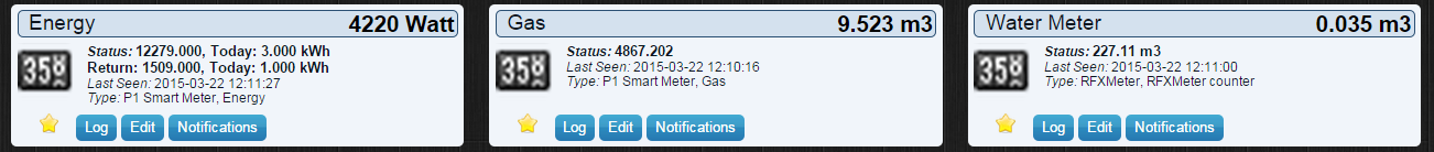

TCRT 5000 can be used for watemeter just fine.Gerwin1967 wrote:Interesting looking for such a solution as well, did you succeed, can you share some pictures and the script you used?
I would not suggest to use the interrupt routines. It gave me a lot of false positives in the beginning.
