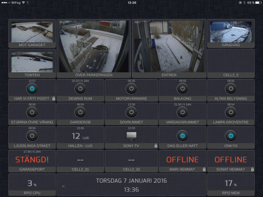

Love this frontpage! Have been poking around and really love the easiness behind it! Great job to you all!
Two questions...
If I create a third page , would it bee to much for the Rasp PI2 & Domoticz to handle. I've already added an extra row to both of the pages, but I feel I need a 3 page.

I also need a third page, sensors and more (virtual) switches keep being added.
The work/cpu time for building the page is done on the tablet (mostly javascript). I use 2 json calls to get the data from Domoticz, the rest is done on the tablet by the browser. Because I read floorplan 0, I already have every switch etc present.

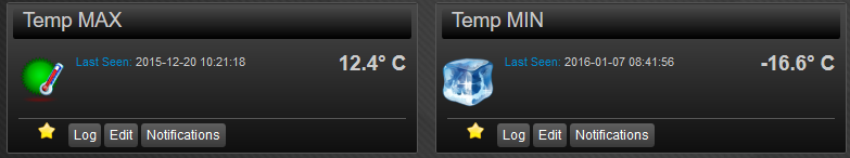

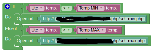

Of course... Here come my small contribution to your frontpage...
It's a bit rough but it works and should be easy to implement if you follow these steps...
I use BLOCKY, 2 dummy TEMP sensors and own made PHP scripts as I don't like lua...
Blocky handles the comparison and checks if actual min temp is lower than registered value... See below:
UTE is the outside sensor.
If actual value is below registered value it runs the php script. My script even notifies me via PROWL...

As seen in the PHP code I update the virtual TEMP sensors whit the actual TEMP and the result is this:
