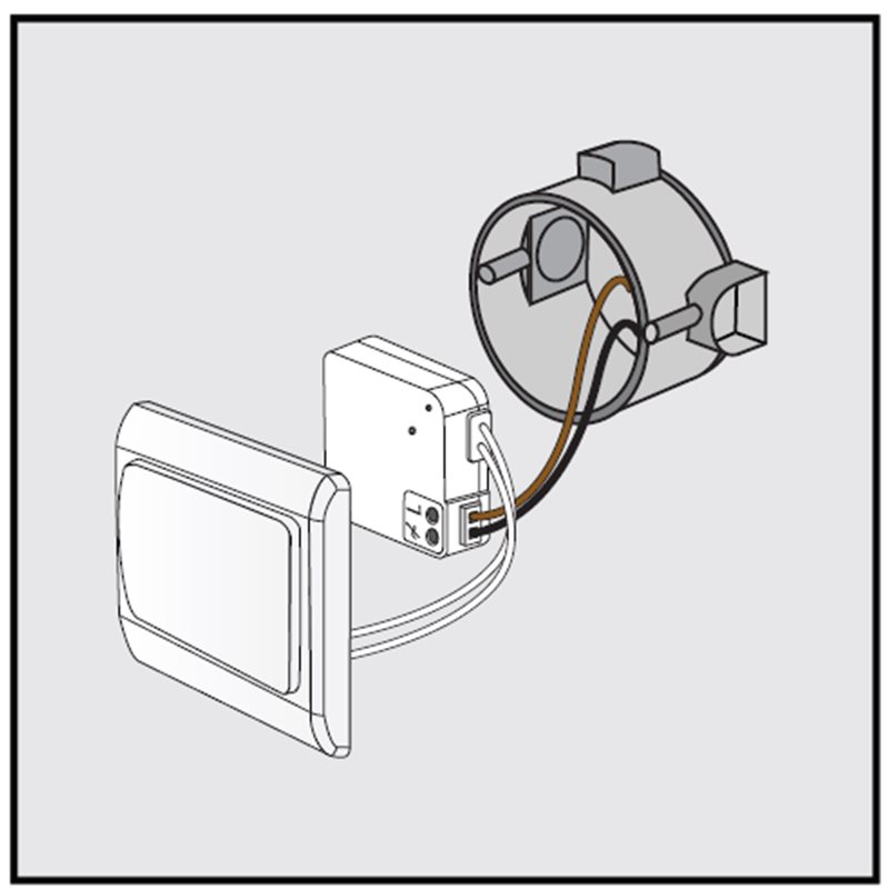

Thanks: the AWMD-250 sounds like an option.
What will happen if I use the AWMD-250 without connecting the white wires. If so I can connect the white wires tot an switch and never touch it.
How does the AWMD-250 gets its juice. It doesn's have a battery.

Re: 230 volt Switch without a N
You can leave the white wires unconnected. Nothing will break.
The circuit gets it's power through a small drain current: A minimal electric current that keeps flowing, even when the light is switched off.
That's why this is only possible with dimmers and not with on/off switches.
