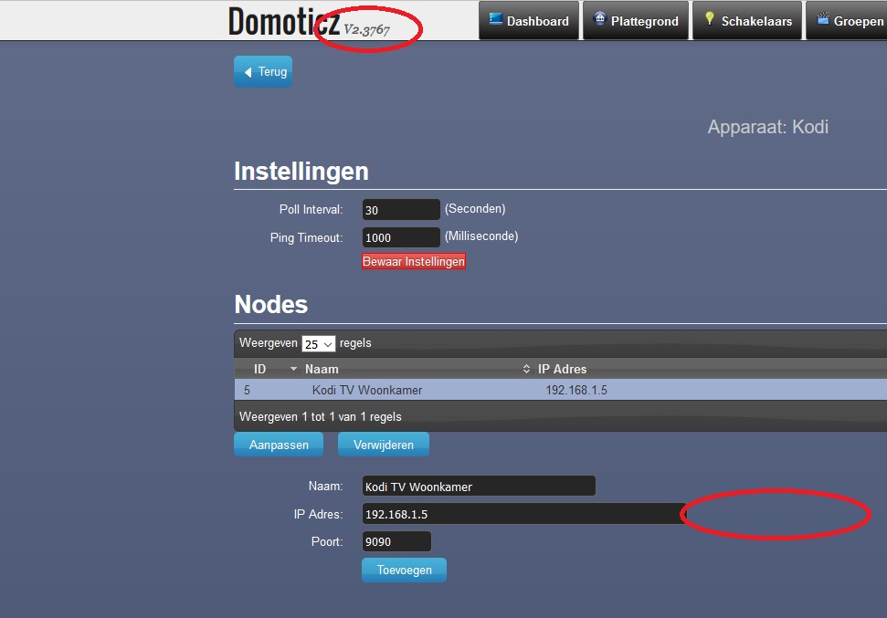

But I don't understand it fully because when you go to the settings from the Kodi Media Server you can enter the IP address but at the end it says: (username:password@IP Address). What username and password is this then? When I enter those from the webserver I get the following errors every second:
2015-12-11 13:50:35.522 Error: Kodi: (Kodi TV Woonkamer) Exception: 'resolve: a fatel error occured while searching in the database' connecting to 'admin:[email protected]'
2015-12-11 13:50:35.623 Kodi: Starting I/O service thread.
2015-12-11 13:50:35.624 Error: Kodi: (Kodi TV Woonkamer) Async Read Exception: 995, The I/O-operation has been aborted because of either a thread exit or an application because of a command.
2015-12-11 13:50:35.682 Kodi: (Kodi TV Woonkamer) Event: 'Off'.
When entering only the IP address the messages are gone. But i see this error every 60 seconds:

As said before, you should NOT do anything with a password. Are you running a current beta version? In the old days you had to connect via the webserver and at that time you needed to add credentials.

Well, I don't understand where your comment about username and password is coming from, unless you are running an older version of Domoticz. Please confirm your build version of Domoticz, you can see that on the Domoticz homepage (V2.xxxx).
For the current versions of Domoticz, port 9090 is used. For the old versions (with usrname /password) the standard webserver port 8080 is needed.
I don't know it either now.. I think I am losing my mind. As you can see in the attachment thats the normal view of the kodi settings page.
At the top you can see the version of domoticz, its a recent version but in the red circle there was yesterday the text: username:password@IPAddress Now I don't see it anymore.
Problems have solved after changing the port to 9090.
