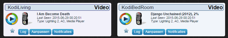

I've seen the new Kod Mediaserver Support functionality
(not my screenshot)
I do not see my mediacenter is active as in the picture above.. Need special settings?

Settings:
IP-adress of your Kodi machine and the port of the Kodi webserver.
When you have set username and password for the Kodi webserver, remove them as this is not (yet?) supported in Domoticz settings.
Edit: also works with username and password.
Add your username and password in front of the ip adress like this:
username:[email protected]

Ah fixed, needed to change my port number to 80 (running openelec, guess this is the default)
