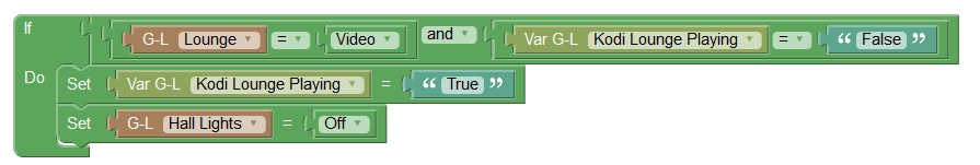

I do something similar and it seems to work (although I'm not doing a string compare but using the status instead)
this turns my lights off when I start playing video. I have a more complicated one to turn them back on again.

Thank you for the suggestion.
I'll try to compare with status and let you know.
Could you post the other event for the lights? Just curious :-)

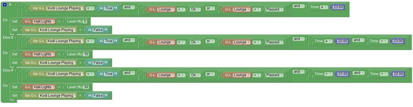

Sure, this dims the same (dimmable) lights depending on the time of night

Thank you for the blockly :-)

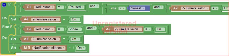

I have a blockly which done on /off light if video is pause or playing regarding time sunset.Ansd it works fine since many weeks but i have not with the "stop button" movie.
kodi blockly.jpg (39.77 KiB) Viewed 5844 times
