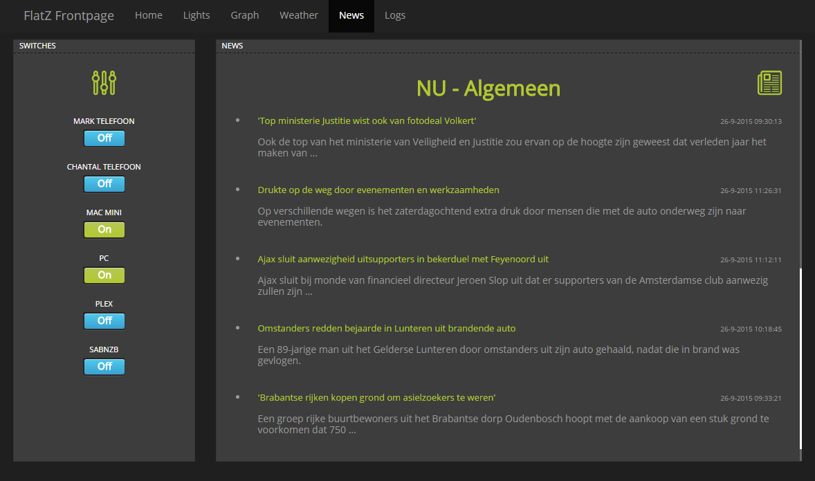

Please check the latest verions:
https://github.com/galadril/FlatZ-Frontpage
- I've added a News page (rss)
- Lot's of fixes bij Patrick (for ipad/device, Rounded css added, fix for Kaku dimmers, etc)

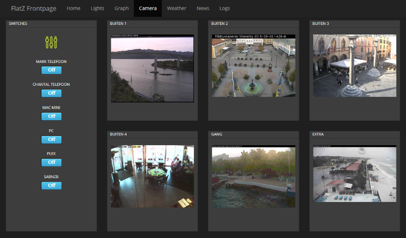

Working on it, It's now working with camera image url...Several people already asked for webcam support...i'd like to support that feature also.

OMG! =)galadril wrote:Working on it, It's now working with camera image url...Several people already asked for webcam support...i'd like to support that feature also.
Cant wait...

Hi galadril, where do I modify the url streams for the IP cameras?galadril wrote:Working on it, It's now working with camera image url...Several people already asked for webcam support...i'd like to support that feature also.
Also in the camera.html I don't see the navigation on the left (Switches) anymore
