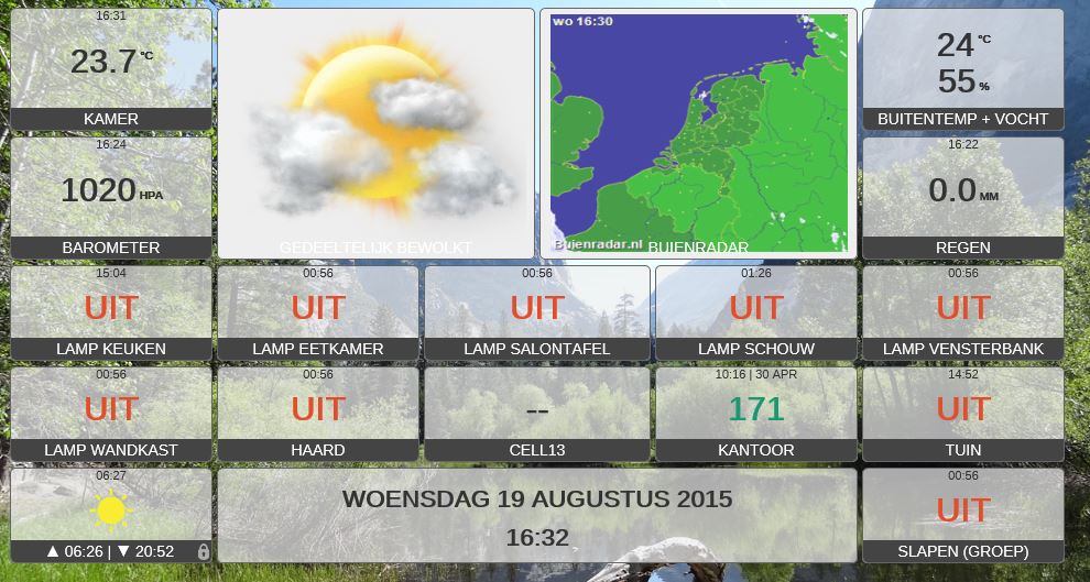

But I would like to make a small adjustment to de big cells(3 and 25)
3 is the forecast and 25 is buienradar.
The forecast makes its own title (ie cloudy or sunny) I would like to see those texts the same color as my other cells (darker title, like cell 1 KAMER)
I cannot find where to adjust it (css?, js)
can anyone point me to the right direction?

You can adjust this in the css files. Add #bottom_cell3 and #bottom_cell25 in the 2 css files around line 110.

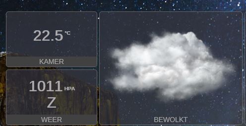

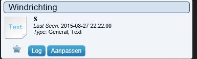

I have a question concerning weather underground.
I want to display wind velocity and direction on the frontpage.
But these figures come all together in 1 idx see below
How can I seperate them?
Thanx in advance
Juan

JuanUil wrote:Hi all,
Thanx in advance
Juan
Juan
you can easaly find it in the Wiki
http://www.domoticz.com/wiki/Virtual_weather_devices
and if you use the FrontPage from G3rard, than the script will change the English phrase to Dutch.
Last edited by bierlaagh on Thursday 27 August 2015 22:28, edited 2 times in total.

Thanx!
That's what I needed!
