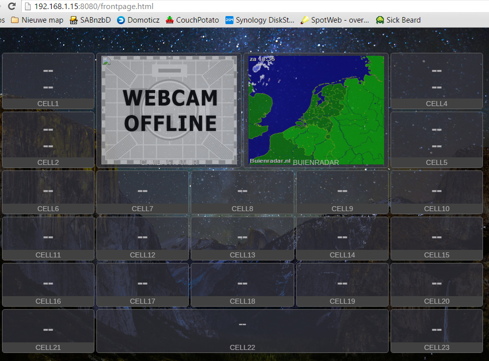

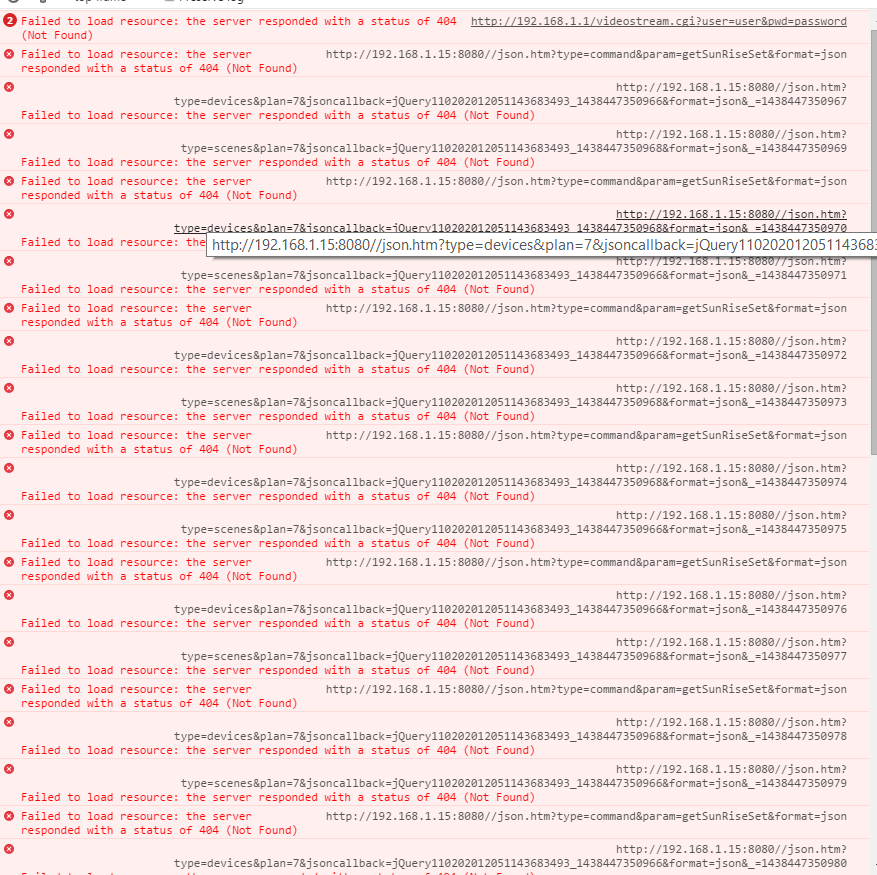

RichardBokker
Posts: 39
Joined: Thursday 09 April 2015 20:57
Domoticz version: 3.9317
Post by RichardBokker »
Hi!
Roomplan change to 0 doesn't matter, it stays te same.
i also tried the default, easy frontpage.htlm. That one is working pretty well :)
Frontpage
Frontpage
COnsole
COnsole
bizziebis
Posts: 182
Joined: Saturday 19 October 2013 14:00
Domoticz version: 3.8805
Post by bizziebis »
Looks like you have one slash too much in 192.168.1.15:8080//
G3rard
Posts: 669
Domoticz version: No
Post by G3rard »
Yes indeed, remove the last slash from domoticzurl in frontpage_settings.js.
Not using Domoticz anymore
RichardBokker
Posts: 39
lol, that is seriosly lame from me haha.. :lol: :lol:
i put the adress in the settings.js indeed with a "/" at the end, that was not needed obviously.
Its working now, thanks! now time to change and adjust :)

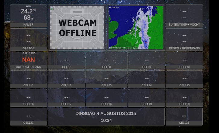

Hello everyone,
I trying to get the frontpage to work. the temp sensors are working, except for the buttons. The buttons are not clickable.
and the light does not react in domoticz. Switch status shows also "NAN'' color does not change either. If i click in normal dashboard the color changes in frontpage.
Source is Github gerard33/frontpage recent release.
['11','Level', 'cell6', 'Hue kamer bank','1','1'],
Any idea's ?
Thanks in advanced

Posts: 669
Post by G3rard »
What does the console in Chrome (F12) show when you have opened the frontpage?
ragsharky
Joined: Tuesday 04 August 2015 10:18
Location: Sittard, Netherlands
Post by ragsharky »
Gerard, Thanks for response.
Chrome element inspector shows no extra click feature on the NAN button. Firefox and IE does also not work. I also looked at the code nothing seems strange.
Where does the "nan" come from? i expect Aan or Uit or On Of
f12 element
f12 element
Thanks.
ThinkPad
Posts: 890
Post by ThinkPad »
FYI:
NaN stands for "Not a number". So it is expecting a number (percentage/temperature/humidity, whatever) but is not receiving that.
ragsharky
Post by ragsharky »
Thinkpad thanks! :D makes sens now.
I manage to get something to work with impuls sockets from action store.
['9','Status', 'cell7', 'Impuls Socket','1','0'],
If i set the last 0 to 1, it start to fail and nothing responses.
My limitless led shows still NAN and is not clickable , My Impuls socket works now! :lol:
G3rard
Posts: 669
Post by G3rard »
@Ragsharky, can you share a screenshot of the Console part? That is the button at the most right, the screenshot above shows Elements.
For a Hue light it should indeed show a number when on (for the dim level).
For a normal on/off light you have to use Status instead of Level. And use a 0 as the last parameter (1 is for dimmer options).
See the examples in my frontpage_settings.js file.
