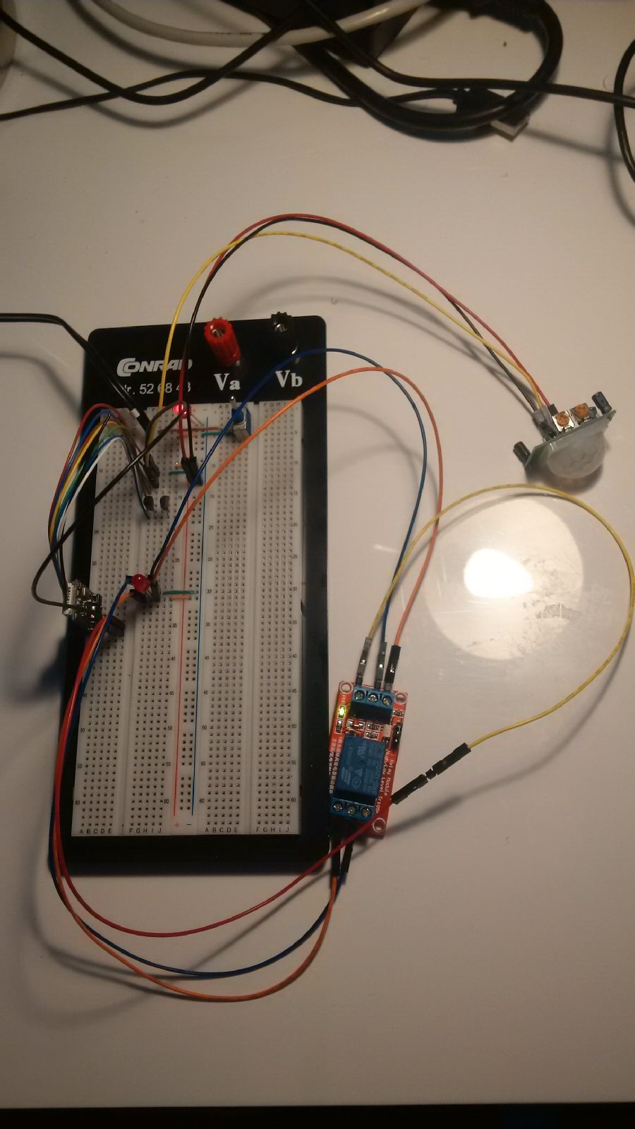

I set up a project which includes a Fibaro Universal Binary Sensor, input from PIR and output to a 12v relay.
I also attached temperature readings form DS18B20.
- The devices show crazy temperatures (169c). I tried with many DS18B20 sensors of different providers. Binary outputs are shown at 255% level always. I have measured the fibaro sensor inputs and DS18B20 pins, and they have always voltage (2,6-3V). Is it normal?
- The output relays are irresponsive.
I am getting desperate about the crazy temperature readings and the inactivity of the output relays. Can anyone tell what is wrong?
Note: dates are wrong, I know.

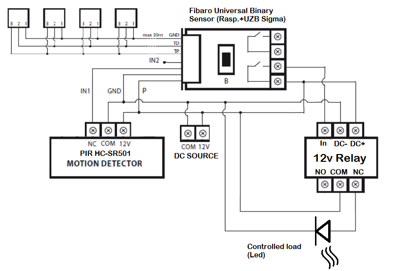

Circuit schematics. All fibaro sensor inputs have always voltage. Is it normal? Anything wrong?

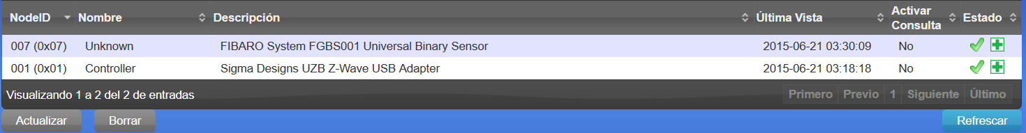

Hardware. Everything seems in place.

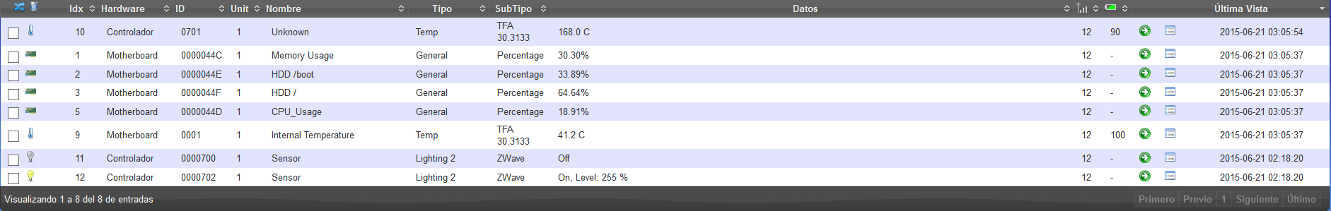

List of devices. These are included without any problem. But readings are confusing.

I have two of these devices working with Aeon Zstick interface (USB).
It IS normal to see voltage on the sensor lines: these are digital ICs containing a sensor element but also analogue-to-digital converter, and bus interface logic. If you probe the sensor lines using an oscilloscope you will see the data transfers in the forrn of pulses. Using a volt-meter will simply give you averaged voltage levels. Full information is available in the device data sheets. It is vital that all sensors be wired correctly as shown in the diagram you provided, and that the cables should be of high quality. The best cable is screened twisted pair. Poor quality cables will not support the high-speed digital communications over a long distance.
One important point: The Fibaro multi-sensor will determine how many sensors are attached (and at what addresses) when it is first associated with your network. If you subsequently change the number of sensors, new sensors will not be recognised unless you exclude the device and re-include it. I think this also applies for a reduction in the number of sensors.
The Fibaro multi-sensor does not have conventional relays - it has opto-coupled transistor-switched outputs. These will follow the state of the corresponding input signals by changing their resistance regardless of the Z-wave operations. It is NOT possible to control these output switches via the Z-Wave network - all the sensor does is to read their state. Some bias supply is required to ensure that a current flows in these switch outputs (and that current should not be too large).
If your system is not functioning as expected, I suggest a check of the sensor wiring, excluding the sensor from the network and then re-including it.
Good luck!

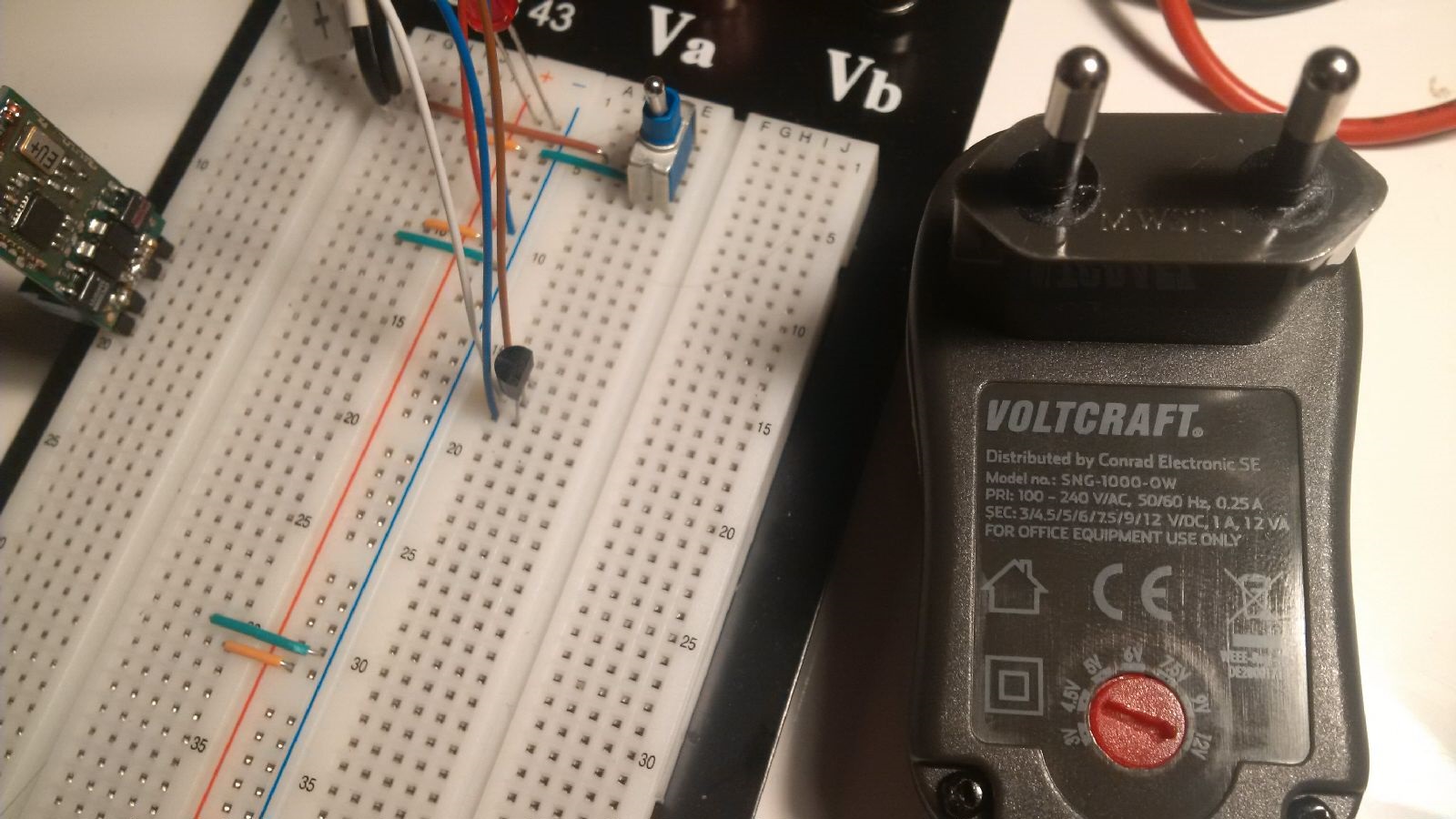

See the pictures of the test circuit with only one probe attached, with the corresponding Domoticz interface.
Power source and test circuit with only one sensor
IMG_20150727_215549 (00000002).jpg (281.75 KiB) Viewed 9386 times
Devices menu. See overexcited, inert sensors. The one at 0 is unplugged. Is it due to harmonic distortion? No idea what causes this.

12VA or 12V / 1A must be enough.
I have 2 running on a 12 / 1A power supply.
But .... I see another 2 units on the same power supply, what do they need ?
Don't see an Elco, take one of 470uF / 25V.
If the A/D conversion for temperature is executed it needs some peak current.
Same for Z-Wave transmission, the Elco takes care of that.
It could be that the multimeter gives an average indication of around 12V, but if one of the 4 rectifiers (brugcel) in your power supply is broken,
there is a huge ripple on your DC.
I see Brown on pin 3 of the DS18B20, Blue on pin 1, White on 2 ... that is correct.

I can understand your desperation.
Your log looks good
2 binary sensors
2 multilevel sensors
But at that time: did you have two DS18B20 sensors connected? On your photo it was only one !
If you change the configuration (or a DS18B20 sensor) you need to Exclude the device and Include it to Z-Wave again. (with the small button on the FGBS001, read the manual)
Are all the wrong temperature values consistent: in your Temperature Tab, in the Devices list and in the OpenZwave Node Management - Control Panel?
If so, the incoming value is wrong.
Then it could be that your FGBS001 is not functioning correct.
Never used OpenHab (or so) but you could give it a try.
Hope the moderators don't kill me :) for this.
keep on trying!
Domosapiens

Thanks Domosapiens.
- I follow all steps described in the manual. Inclusion and exclusion are always successful and all devices are well detected.
- Yes 2x DS18B20 were connected. I tried five different temperatur DS18B20 sensors and they are always successfully detected, but with the same crazy output frozen on the top of the scale. All temperatures are the same.
- Yes, all values are crazy but consistent among menus.
Let´s see that openHab, but I am not very optimistic ...
