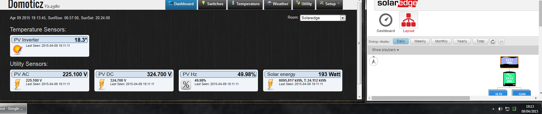

Sorry for my bad english,
When i take look by domoticz on the solaredge device can i sea: Last turn on: 2015-04-07 16:07:57
when i take a look to the monitor of solaredge (http://www.solaredge.com) is the last that i can sea 16:53
domoticz monitor do not update the real time when they send to solaredge
The solaredge inverter send to domoticz and domoticz to http://www.solaredge.com/
I hope that you can now understand me

I have now two print sceenes maked
Look at the time.
Look at the time.

Re: SolarEdge in Latest Beta / Port Number
No problem here.
- se.PNG (229.63 KiB) Viewed 6320 times

Allso found system which is logging through RS485 SolarEdge => Sunprofit perhaps something for the developers to cooperate
