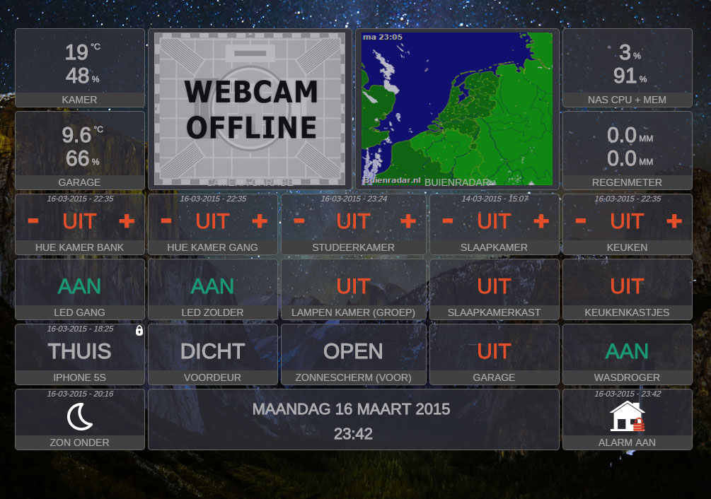

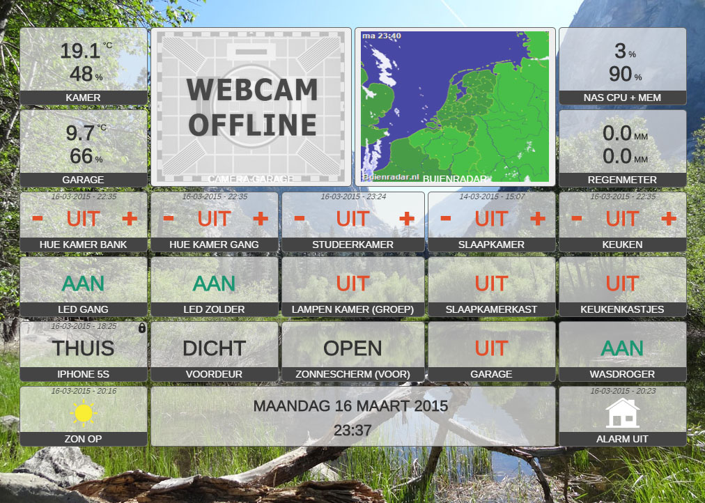

Here is the link were youy can download my frontpage.
http://www.filedropper.com/frontpagegz
The frontpage has a.o. the following changes compared to earlier versions posted in this topic.
- text with cell description changes according to the state (eg alarm on/off, sunrise/set)
- removed bounce effect (no vertical scrolling) on iPad
- use extra div's in the cells above (see also the post from zicht) to show 2 values in one cell
- various layout changes
Let me know if you have any questions regarding the configuration.

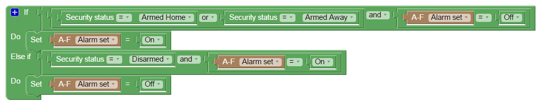

One question: how do I get the alarm-icon ( house-icon ) running ?
I can enable the alarm via the security-panel. I made a blocky where I set a virtual switch to ON when one of my kaku doorcontacts opens.
But, I when I use the IDX of that virtual switch in cell23, it just shows OPEN or CLOSED. Not your icon...

There are 2 options for the alarm.
1.You can use the security panel from Domoticz, then you have 3 values (Normal, Armed Home, Armed Away).
When you want to use this option, you have to set the floorplan to 0 in the settings file (because the security panel of Domoticz can not be added to a floorplan).
You also have to set the right idx for idx_Alarm (in this case the idx of the security panel) and the right text for desc_alarm_away, desc_alarm_home and desc_alarm_off in the frontpage_settings.js file.
In the frontpage.js file this option uses the following code (starts at line 249)
// set alarm icons
	if(item.idx == idx_Alarm && vdata == 'Arm Away'){
	vdata=new String(vdata).replace( "Arm Away","<a class=iframe href=secpanel/index.html><img src=icons/alarm_away.png vspace=6></a>");
        vdesc=desc_alarm_away;
	if(item.idx == idx_Alarm && vdata == 'Arm Home'){
	vdata=new String(vdata).replace( "Arm Home","<a class=iframe href=secpanel/index.html><img src=icons/alarm_home.png vspace=6></a>");
	vdesc=desc_alarm_home;
	if(item.idx == idx_Alarm && vdata == 'Normal'){
	vdata=new String(vdata).replace( "Normal","<a class=iframe href=secpanel/index.html><img src=icons/alarm_off.png vspace=6></a>");		// day
        vdesc=desc_alarm_off;
This code is active in my version of the frontpage.
2. You can use a virtual switch. Make sure that's an On/Off switch and that you use the right blockly, see my explanation below.
You have to set the right idx for idx_Alarm (in this case the virtual switch) and the right text for desc_alarm_on and desc_alarm_off in the frontpage_settings.js file.
If you want to use this option, then you have to enable to following code in frontpage.js (starts at line 263) by removing the //. This means you have to disable the other alarm code which starts at line 249.
	//if(item.idx == idx_Alarm && vdata == 'Off'){
	//vdata=new String(vdata).replace( "Off","<a class=iframe href=secpanel/index.html><img src=icons/alarm_off.png vspace=6></a>");
	//vdesc=desc_alarm_off; // Replace text from bottom with text from settings file
	//if(item.idx == idx_Alarm && vdata == 'On'){
	//vdata=new String(vdata).replace( "On","<a class=iframe href=secpanel/index.html><img src=icons/alarm_on.png vspace=6></a>");
	//vdesc=desc_alarm_on; // Replace text at bottom with text from settings file
Option 2 only shows if the alarm is on or off, where option 1 shows the same status as Domoticz.
Furthermore you also must change your blockly so it uses the security status of Domoticz and not the status of the door contact.
The virtual alarm switch must be managed by the security status like in the blockly below.
Then you can make another blockly which starts an action if the alarm is set and the door contact opens.

hm, seems my 'buienradar' is not working in frontpage anymore.
Anyone else has the same problem or is it just me?
Heisenberg
Posts: 135
Joined: Monday 27 January 2014 14:12
Post by Heisenberg »
Me too. Seems api of buienradar doesn't work anymore
Raspberry Pi Type B
Raspberry Pi Type B2
RFXCOMtrx433e
Siewert308SW
Posts: 294
Joined: Monday 29 December 2014 15:47
Domoticz version: Stable
Post by Siewert308SW »
Same here,
Buienrader change their API so i used G3rard his url found in his frontpage.html
Setup:
- DS923+ Docker
Domoticz Latest Stable
Mosquitto / ZwaveJSUI @ Aeotec Z-Stick Gen5+ / PiHole Unbound
P1 USB Gas/Power, HW watermeter
- A lot of Zwave switches, contacts, plugs, smoke/Co2 ect
- DiY 7.5kWh Solar Storage @ GitHuB
jannl
Posts: 823
Domoticz version: 2025.5.x
Location: Geleen
Post by jannl »
thx, that worked
