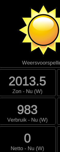

As I use solar panels I regulary have a negative electricity consumption. When this happens Frontpage displays 0 as a value instead of the expected say -1070W. Is there an option to have is nicely displayed either with the '-' sign in Frontpage or say in green when negative (exporting electricity) and red when positive (importing electricty)?
This how it is my settings file
['89','Usage', 'cell17', 'Netto - Now (W)','0','0']
where the current value = - 1070 W and the value is derived from my smart (P1) meter, device 89
Anyone an idea how to?

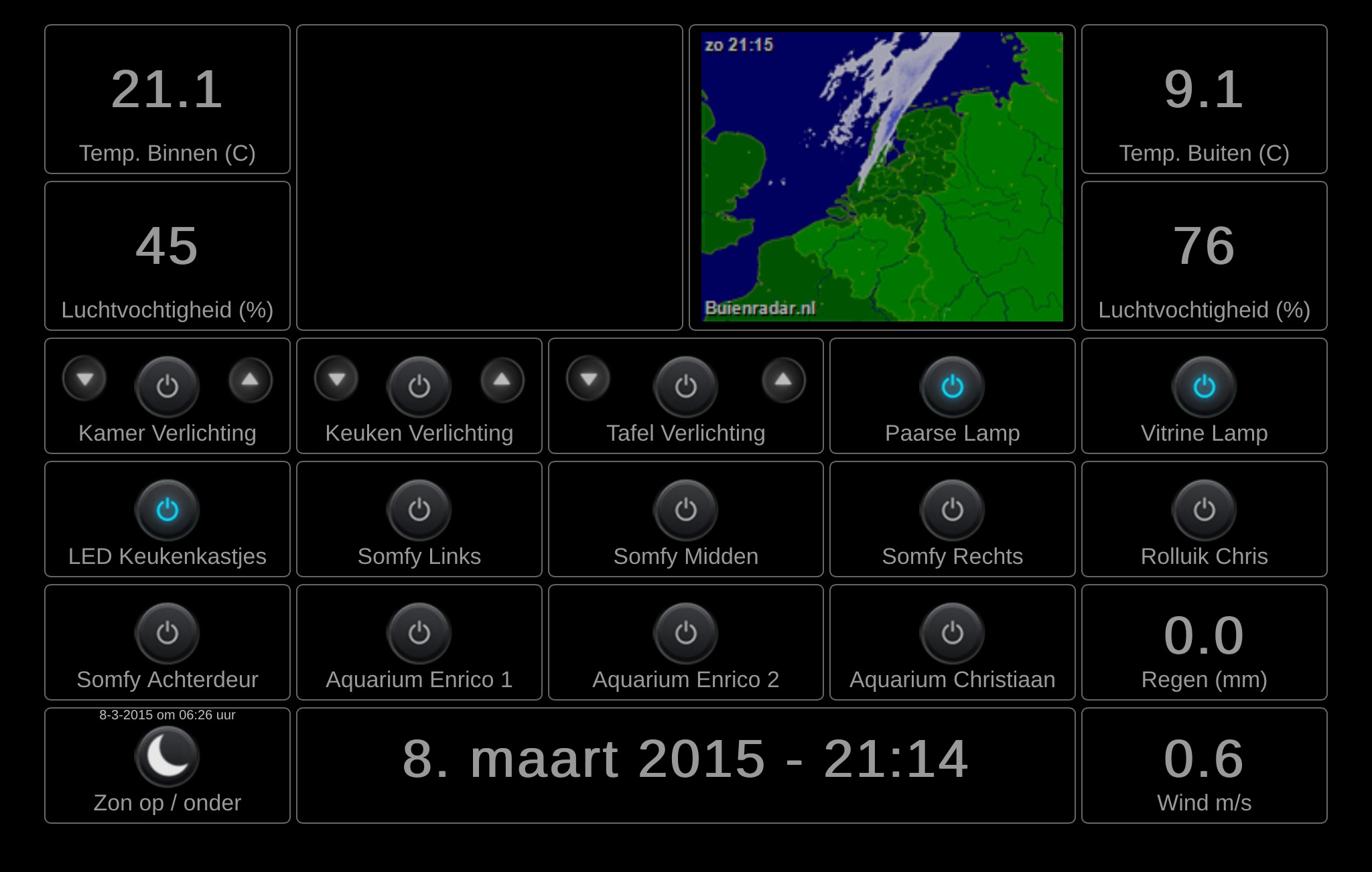

This is a great topic and makes live easier to switch and check status on a tablet on the wall. :D
I ran into some question marks on how to get some thing arranged and I have already been scouting the forum to find the answer in which I was unsuccesfull till now.
I now turn to you guys for help.
See the screencapture of the what I have up till now and I'm looking to have a live camera feed in the left over cell which is cell3 and all the somfy's and the one Blind (rolluik) provide a clear status but I cannot get them to action when I push the button.
Can some one help me with the instruction to implement the life feed which ultimate I would like to have taking a picture when someone pushes the doorbell button and save this picture on my Raspberry Pi. Also which code do I need to implement or change to get the buttons to action the blinds to open or closed.
Frontpage.html till sofar.

I am using the following in frontpage.html for my camera. It also depends on your camera brand.
<div id="cell3"><img src="http://username:password@ip-address/videostream.cgi"  onClick="lightbox_open('camera', 25400);" width="200px" class='camera' /></div>
It's not showing the feed in Chrome on the PC, but is does show the feed in Safari on the iPad.
I also have two somfy's, but not yet configured them. Will do that and try to get it working in the frontpage. Will let you know if I get it working.
