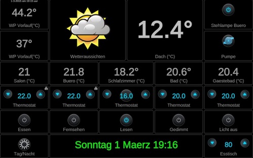

That's how it looks like now here
Still small issues:
1. How to get rid of the lock-signs wthout changing width of the cells
2. Get the degree sign behind all the Type == temp
I tried
but this not working for all cells.
3. Howto implement wheather radar?
Tx to all for sharing and for help.
Still small issues:
I tried
// Adds the Celsius sign after the temperature
if(viType == 'Temp' && vdata > -100){
vdata=new String(vdata).replace( vdata,vdata + "°");

Thanks, hope that I have time next week to work with it!jkimmel wrote:Just copy and paste my code replacing yours and tell about the outcome.floris74 wrote:Hey jkimmel,
How dit you fix the multiple thermostats then? Looking forward to the FP with thermostat and dimmer support..
Floris

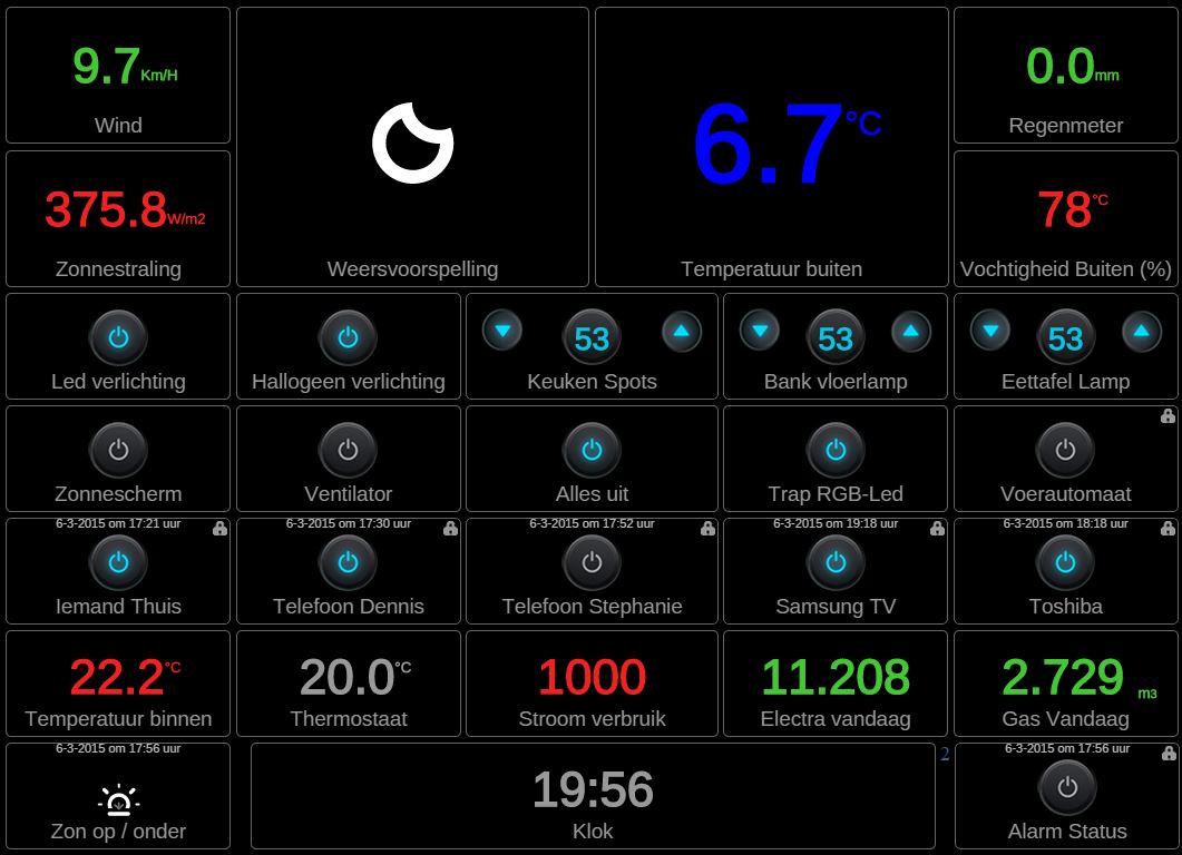

What if you use vType instead of viType?jkimmel wrote: That's how it looks like now here
Still small issues:
I triedbut this not working for all cells.Code: Select all
// Adds the Celsius sign after the temperature if(viType == 'Temp' && vdata > -100){ vdata=new String(vdata).replace( vdata,vdata + "°"); }
For me this works in all cells.
You can use it for whatever you want to put behind the value.

That is a nice design Bizziebis, would you like to share with us how you made this?
I really like the glossy look of the buttons

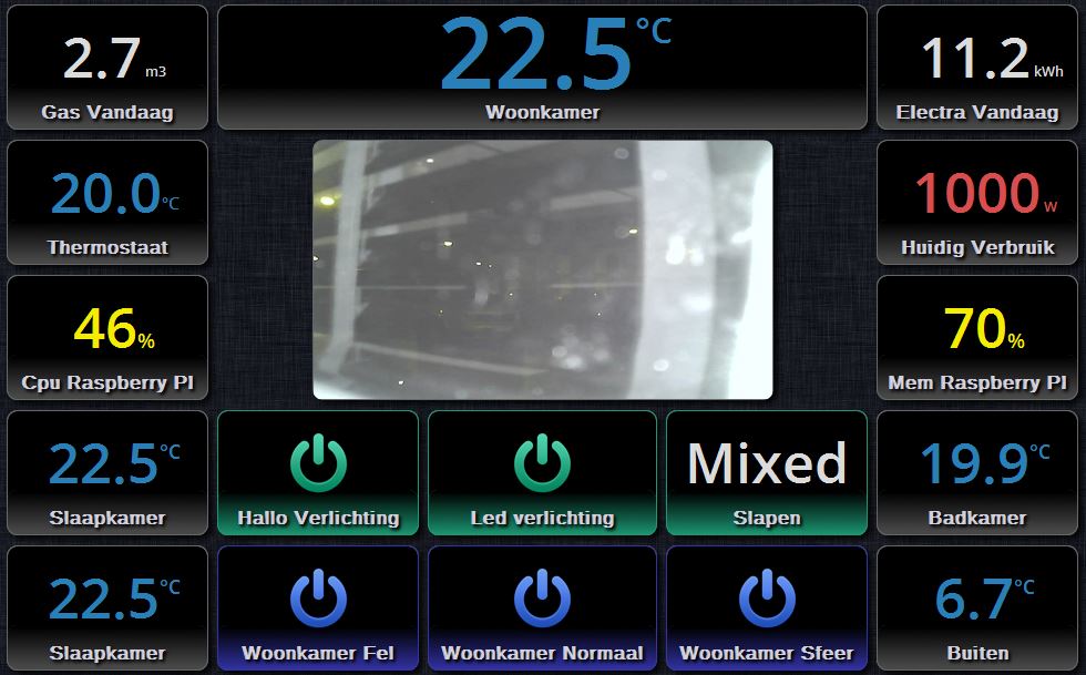

Can you share your (.css) code for the buttons? And maybe for the Kwh, m3, L, etc. ?bizziebis wrote:

Here it is:
I made a lot of changes to suit the display size of my tablet. Also some of the tricks to display the "C", "kWh", "W" and "L" will not work for everybody. Changes need to be made acording to the hardware you use. That's not a big problem. Everything you need is supplied by JSON
I would advise to only "borrow" the code you like, but not use this frontpage directly. It can give you some nasty side effects.
(Dimmer support is completely broken as far as I know
, I don't use it)
If you need more information about how I did something, feel free to ask. I'll try to explain or adjust it to your needs.
