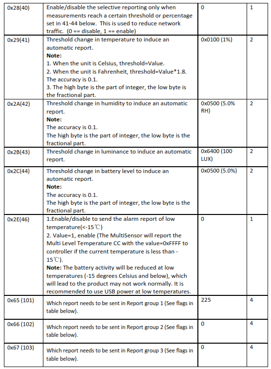

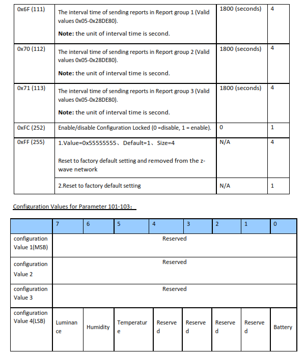

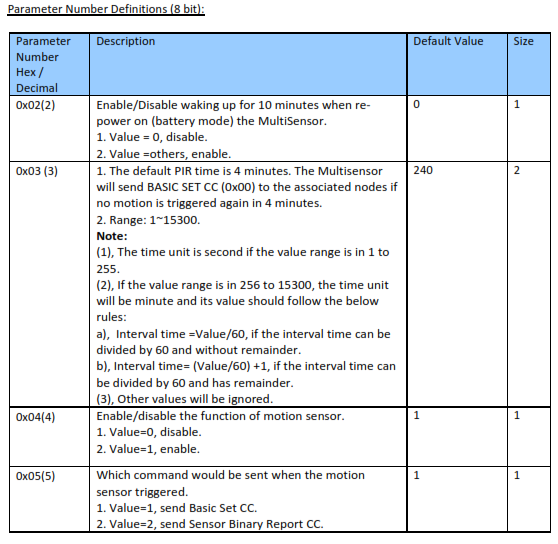

Got these from Aeon Labs :

The Multisensor Gen5 devices are fully updated as is, they do not have new firmware to update as they are a new line of products. I will be updating the support page in the near future to reflect that.
The guide that you looked at is most likely for the older generation Multisensor. All new firmwares will be OTA (Over The Air) updatable. If you've purchased the Multisensor Gen5, then you have the latest version at the moment.
Wake up Gen5 Multisensor:
Press and hold for 3 seconds on the Multisensor, this should send a wake up notification to your controller.
Problems with Motion Sensor:
Since the Multisensor Gen5 uses a security command class, you may have to modify the Motion sensing parameters. Sending a Basic Set CC will hold issues with the new security CC.
To fix this, we need to change what the Multisensor sends when it triggers motion:
Parameter 5 [1 byte dec]: 2 (Send Sensor Binary Report)
OR
Parameter 5 [1 byte dec]: 3 (Send Sensor Binary and Basic Set CC Report) [In my opinion, it is better to have the Multisensor send both reports at the same time
There are more added parameter settings in the Multisensor Gen5 vs the older Gen5 version than what is shown in the pepper1 site (and he included above pictures as welk).

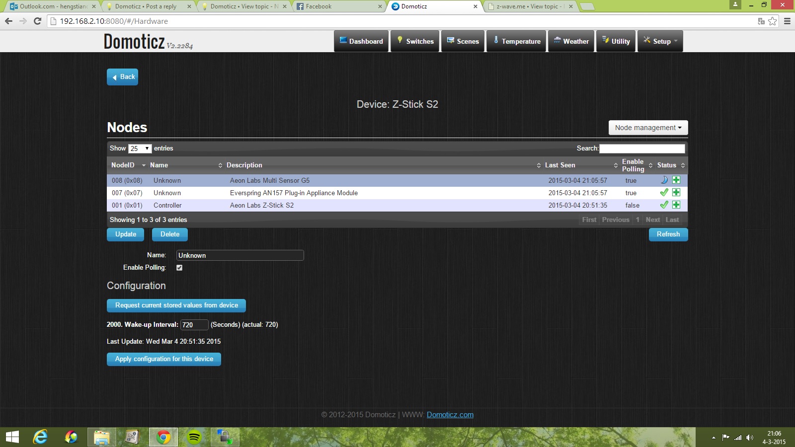

Gentlemen,
After thoroughly reading this specific topic, I still can't get to the Configuration as shown by IDavid on the 27th of Feb. Included you can see what I see for Configuration. Since it's impossible to connect with my new Multisensor through the usb-cable, I need to get to any interface through Domoticz. What I read here was promising, but for me: it still won't work. Can anybody please tell me what I am doing wrong here?
- Screenshot.jpg (337.27 KiB) Viewed 7394 times

Thanks, that would be of great help. But I've read some frustrations over here indeed...
(As for the added line in the manufacturer_specific.xml: I did that and rebooted my Pi, which didn't work. Obviously that was before posting my reaction on the topic.)

Got it! Simply never used the inclusion button correctly! This is one hell of a brilliant feat. from Domotics to be able to include without using the stick! I couldn't find it anywhere, so for anyone else looking for this:
Inclusion of a (new or excluded) node is done by leaving yer Z2 Stick in your hardware device (Raspberry for me) and just press 'Include node' and then the inclusion button on yer Sensor. Through this, it will not only include in yer Zwave network, but also in Domoticz.
Now let's see what to control...

Same problem here.
I have the previous version which works fine (should have bought two in stead of one) and now a second one GEN5.
Including was simple, shut down The Domoticz Pi, removed the Aeon Zwave stick, included the sensor and rebooted the Pi.
Pretty soon i was able to include the new sensors, but motion doesn't work yet and other sensors are not working or randomly.
I must admit i am not over experienced with Zwave, but with the other sensor i have other results.
