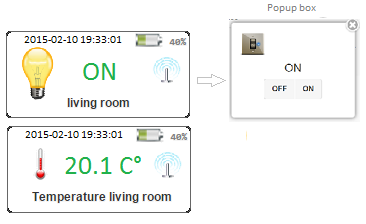

Is it possible to get so more info on the sensor box like the image if yes how?.
I like the layout very much
- ImageHtml6.png (19.31 KiB) Viewed 7074 times
