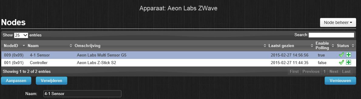

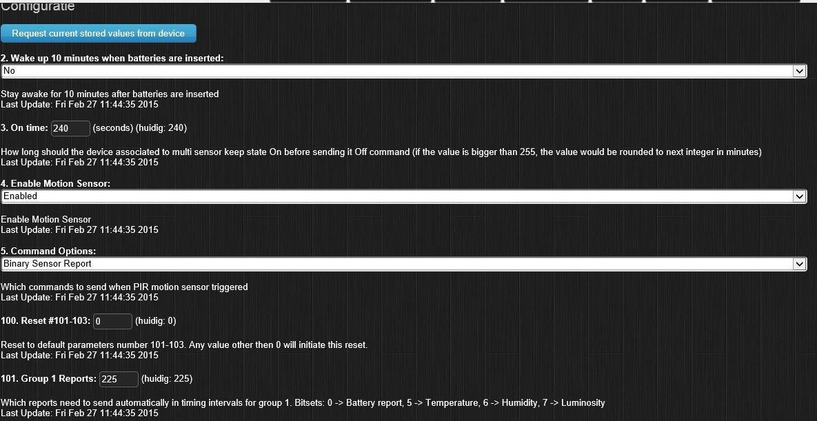

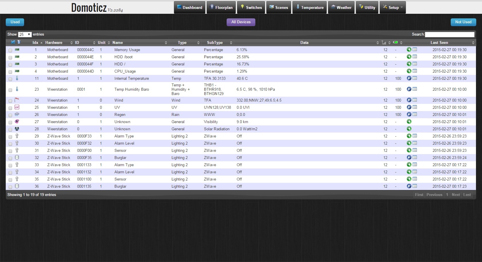

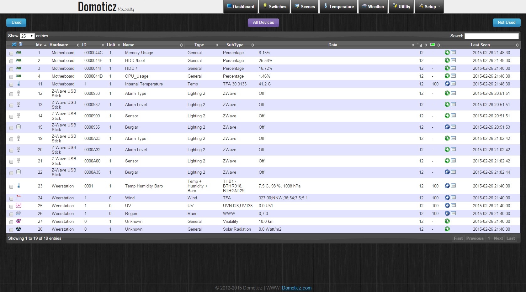

Hello, so here's my first post on this Domotics forum. All new to programming and the Raspberry but I'm already liking it.
After fiddeling with my new Pi 2, the Aeon Z-stick and 2 Multisensors Gen 5 I got everything working but not the motion detection part. Lux. temp and humidity are working fine...
I allready searched the forum and found the Group 1 setting problem but I can't get to these settings in the Node Management - Control panel. I got the feeling that OpenZwave does not yet reconizes the new MultiSensor Gen5. In the OpenZwave folder I can find the configuration file for the 'old' MultiSensor but not the new Gen5 with Z-wave+.
Anybody an idea about this issue ? Help is highly apreciated !
Screenshot 1.jpg (217.46 KiB) Viewed 11671 times
Screenshot 2.jpg (99.04 KiB) Viewed 11671 times

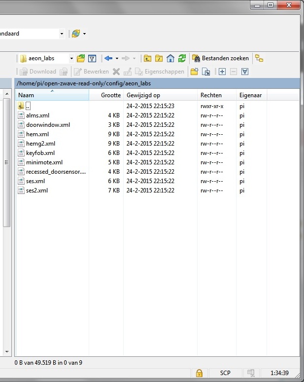

in the /domotics/Config directory there is a manufacturer_specific.xml.
Find the entry:
<Manufacturer id="0086" name="Aeon Labs">
<Product type="0000" id="0000" name="Z-Wave Extender"/>
<Product type="0001" id="0001" name="Z-Stick"/>
<Product type="0001" id="0002" name="Z-Stick S2"/>
<Product type="0001" id="0003" name="Minimote" config="aeon_labs/minimote.xml"/>
<Product type="0001" id="0007" name="Z-Stick S2 Lite"/>
<Product type="0001" id="0016" name="Key Fob" config="aeon_labs/keyfob.xml"/>
<Product type="0002" id="0001" name="Z-Stick S2"/>
<Product type="0002" id="0004" name="Door/Window Sensor" config="aeon_labs/doorwindow.xml"/>
<Product type="0002" id="0005" name="Multi Sensor" config="aeon_labs/alms.xml"/>
<Product type="0002" id="0009" name="Home Energy Meter" config="aeon_labs/hem.xml"/>
<Product type="0002" id="001c" name="Home Energy Meter G2" config="aeon_labs/hemg2.xml"/>
<Product type="0002" id="001d" name="Door/Window Sensor" config="aeon_labs/doorwindow.xml"/>
<Product type="0002" id="0036" name="Recessed Door Sensor" config="aeon_labs/recessed_doorsensor.xml"/>
<Product type="0003" id="0006" name="Smart Energy Switch" config="aeon_labs/ses.xml"/>
<Product type="0003" id="0008" name="Smart Energy Illuminator"/>
<Product type="0003" id="000a" name="Smart Energy 220V Utility Switch"/>
<Product type="0003" id="000b" name="Smart Energy Strip"/>
<Product type="0003" id="000c" name="Micro Smart Energy Switch"/>
<Product type="0003" id="000d" name="Micro Smart Energy Illuminator"/>
<Product type="0003" id="000e" name="Micro Motor Controller"/>
<Product type="0003" id="0011" name="Micro Double Switch" />
<Product type="0003" id="001a" name="Micro Switch (2nd Edition)"/>
<Product type="0003" id="001b" name="Micro Smart Energy Illuminator G2"/>
<Product type="0003" id="0012" name="Micro Smart Energy Switch G2" config="aeon_labs/ses.xml" />
<Product type="0003" id="0013" name="Micro Smart Energy Dimmer"/>
<Product type="0003" id="004b" name="Smart Energy Switch v2" config="aeon_labs/ses2.xml"/>
<Product type="0004" id="0025" name="Z-Wave Repeater"/>
<Product type="0004" id="0050" name="Siren Gen5"/>
<Product type="0002" id="004a" name="Multi Sensor G5" config="aeon_labs/alms.xml"/>
</Manufacturer>
Add the entry marked in RED. This entry is a copy of the Original Multi Sensor entry for earlier generations (<Product type="0002" id="0005"). This will give you the usual settings for the Aeon Multi sensor which are configured in the related alms.xml
Although you now can change all settings, you might need to enable the 'Sensor' switch you will get with this hardware. I'm not to sure about that.
Hope it helps.

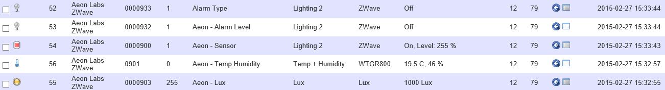

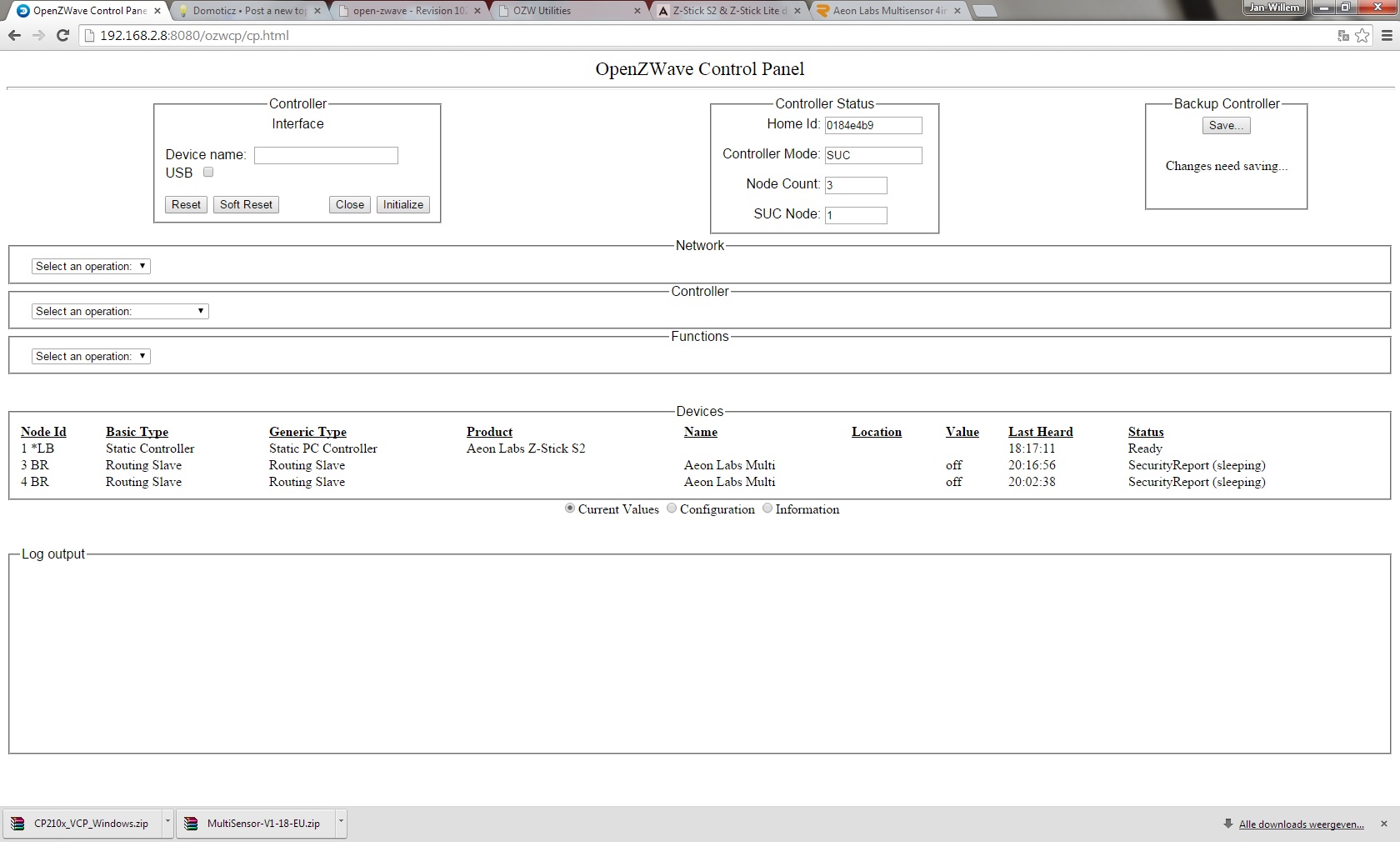

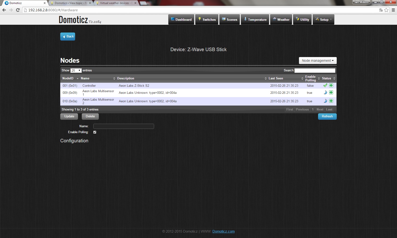

I'm a bit further than yesterday. Build the whole Raspberry SD card again from scratch but it didn't want to include the sensors again. Because I was fed up with it and it was late I left the Raspberry on.
Just tried the inclusion again and the sensors are included ! But now the Domoticz software doesn't reconize them, just as : Aeon Labs Unknown: type=0002, id=004a. Again the sensors seem to work very well (NOT) on the device page. I tried the use the Burglar entry as motion sensor but nothing happens. Anybody an idea ?

Het-Licht
Posts: 29
Joined: Monday 14 July 2014 21:16
Location: Nederland
Re: New Aeon Labs Multisensor Gen5 not supported in OpenZwav
Post by Het-Licht »
Screenshot 3.jpg (374.09 KiB) Viewed 11573 times
IDavid
Posts: 10
Joined: Wednesday 25 February 2015 22:08
Post by IDavid »
Did you exclude the sensor from 'Node managment' and did you check all devices were removed? You might want to restart the server/raspberry afterwards.
After doing so, and making the changes to the manufacturer_xxxx.xml file described before, the sensor should be recognized. The only thing I changed afterwards is changing the switch type from 'On/Off' to 'Sensor'.
As a result (I tested this) the sensor switch will be active when motion is detected.
The sensor 'Alarm Level' is just a virtual switch you set to 0 (home) or 255 (away) and the alarm type switch is just a virtual switch used to notify if the alarm was caused by motion, lux change etc..

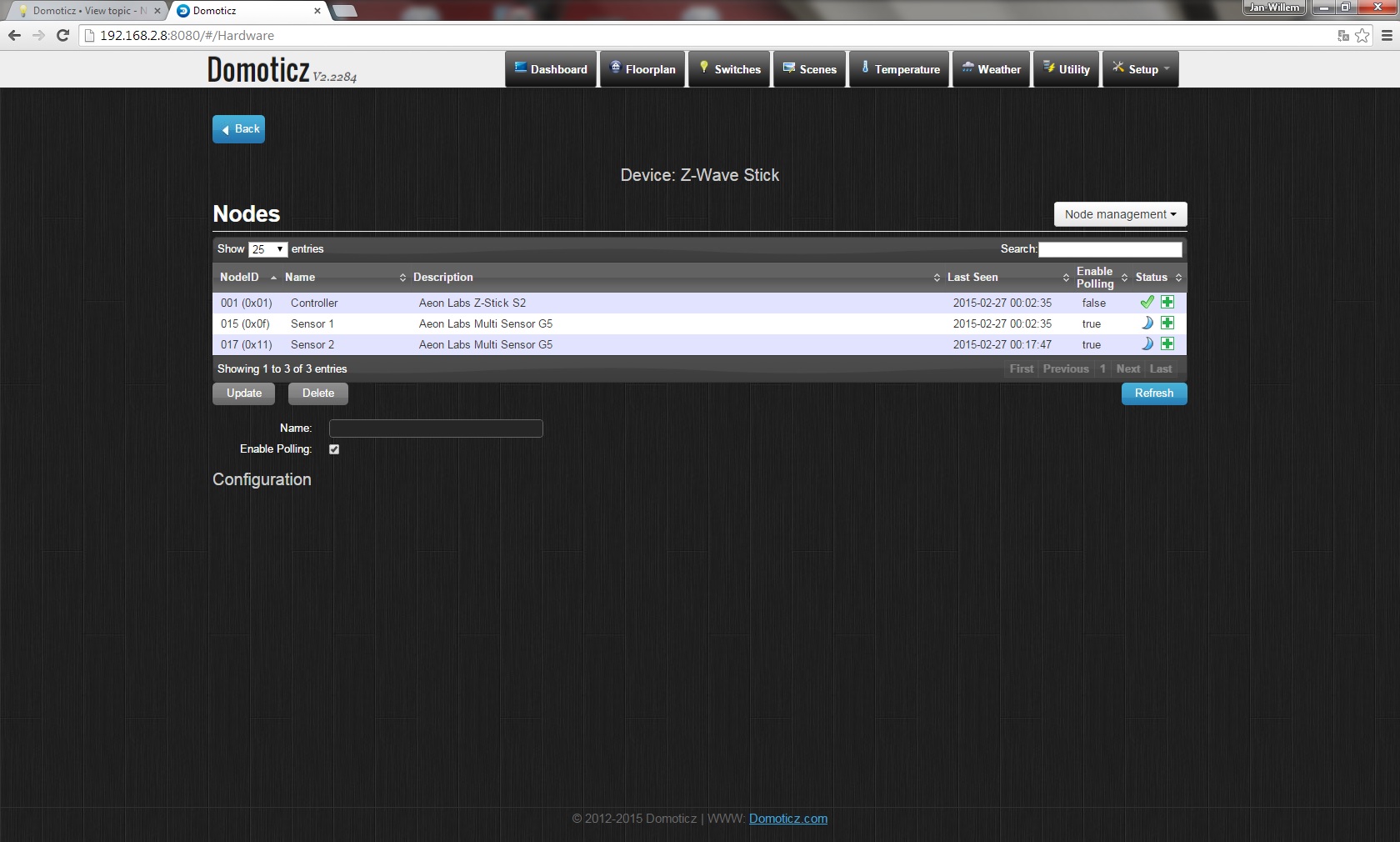

IDavid wrote:Hi,
</Manufacturer>
Hope it helps.

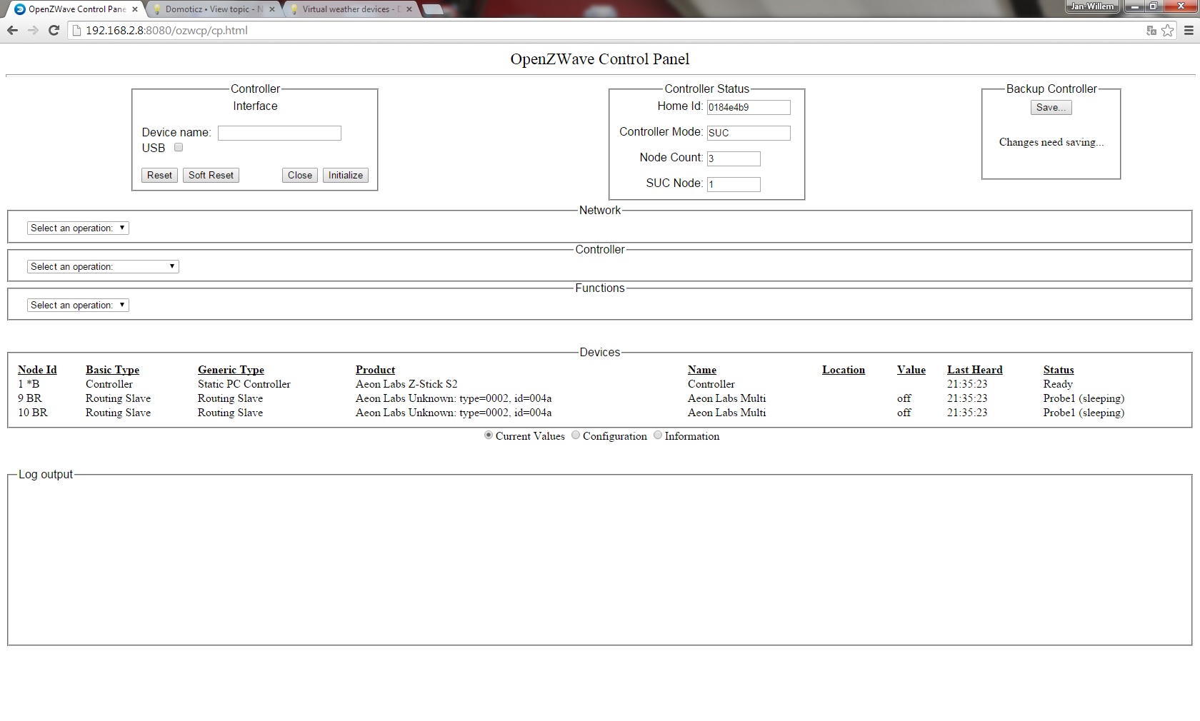

Thanks for this info. At first I didn't understand you, but I changed what you discribed. Now the sensor is reconized as G5 but still not working...
Screenshot 1.jpg (330.15 KiB) Viewed 11542 times
Screenshot 2.jpg (380.03 KiB) Viewed 11542 times

I have the same problem. Tried with the old configuration "alms.xml" but for the 4 devices created by domoticz nothing changes. Only LUX, Humidity and Temperature by configuring the parameter 101. to 225 are working.
IDavid
Posts: 10
Post by IDavid »
@het-licht
You still have a double entry for the aeon multi sensor in the node setup and I also see the devices twice.
I assume you only have 1 device though.
Select the node button and exclude the device, or select the node and select the option to ' remove' node. Also check then that all devices are removed for this aeon sensor. Then reboot the system.
Then try to include again from the node button.
In your case, having twice the entries messes up
Another remark, when everything works, the discovered switch device named sensor should be set to type sensor. I'm not sure what you named ' burglar' is the correct one.
As noted by other user, entry 101 in the configuration settings should be set to 225 to get reports for all other sensors. Set parameter 2000 to 720 if you want a report every 12 minutes, and select 'enable polling' if you want to receive the reports. If you don't select polling you only get results for the other sensors when motion is detected.
Be aware, depending on the 2000 parameter setting and the polling interval of your aeon s2 sensor, it takes some time to get initial results.
Don't give up. It will work eventually as has been tested in my case.

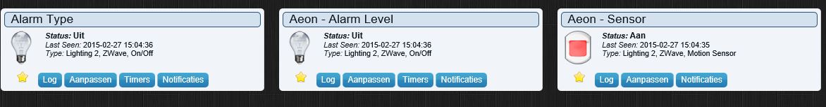

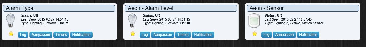

Devices overview after configuratation:
devices
devices
Switches overview:
(The alarm sensor device type has been changed to type 'motion sensor' (default is on/off):
No motion detected:
switch off
switch off
switches status off.JPG (44.24 KiB) Viewed 11437 times
With motion detected
switch on
switch on
switches status on.JPG (42.95 KiB) Viewed 11437 times
As a result, the sensor is 'red'.
Keep in mind: parameter 3 in configuration sets the time for which sensor state is on (red colored), in this case 240 seconds. After 240 seconds, sensor is off (greyed out) until new motion is received. Parameter 4 is setting motion detection on/off.
