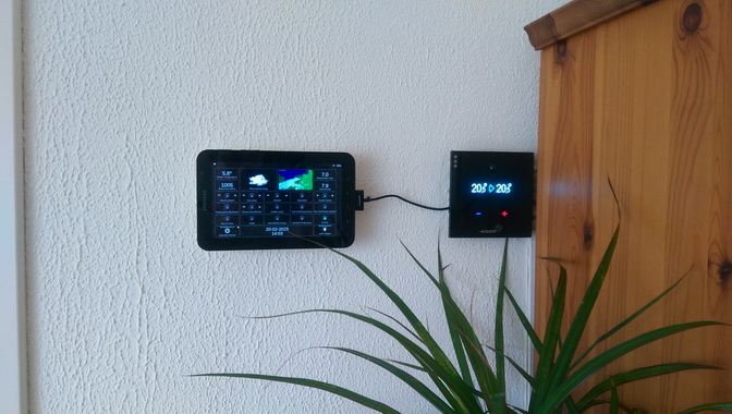

Titanium87 wrote:
Siewert308SW wrote:Wanna thank those who started this.
Had a old Samsung Galaxy Tab 7" eating dusk.
Last night i prepared it to run 24/7 with additional apps to beable to use Voice commands which is my next project to kill some time.
Today i made a wooden frame which only need some paint. ;-)
But here is my test setup...
Sorry if I missed it, but what software do you use?
I have a galaxy tab 7.0, and I cant seem to get the bar over and under away.
Over I have the battery and wifi symbols, and under I have the "back", "home" and "the other right one Image ".
I use chrome in the "home-screen-app version".
If you can miss some cents: https://play.google.com/store/apps/deta ... ri.hidebar
Works perfect with the frontpage added to homescreen with chrome browser. No bars at all.

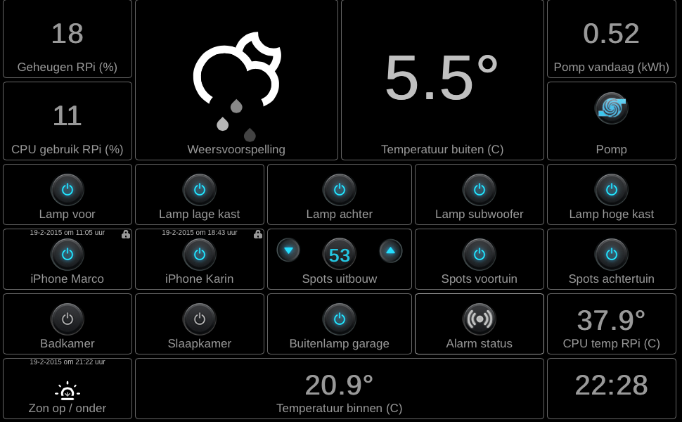

mvveelen
Posts: 710
Post by mvveelen »
Too bad I can't edit my posts anymore after a few minutes.....I just wanted to add a little thing :
Every cell has a description, but the cell where the time is displayed hasn't. So I changed the code in frontpage.js:
Find:
var vdata=      currentTime();          // Get present time
var vdesc = '';
Change:
var vdesc = 'Klok';
Or use something you like :)

Post by Atmosphere »
Hi All!
Thank you for all the work you have been doing!
It resulted in a great frontpage for my Domoticz system.
I've been following this forum for quiet some time now...
Time to give something back!
As I am the owner of an OpenTherm Gateway, just like jkimmel and floris74, I wanted to be able to set my Setpoint with the buttons used for dimming.
I own an opentherm Remeha Avanta in combination with an Remeha iSense thermostat.
It resulted in some hacking into the code already created but I managed to get it working the correct way.
Now you can adapt your setpoint from the couch! My thermostat gets changed from changing the setpoint...
My solution is integrated into the last release from 17 Feb by mvveelen.
Also I changed some hardcoded idx settings to look for the variable in the frontpage_settings.js. (Might be wise to keep idx nr's out of other files but settings.js)
For more overview I changed some of the folderpaths, so install the attached zip in the correct directories (under www)
During altering the code I broke the locked sign on protected switches, don't know how to fix that... Could anybody help?
Also it doesn't show the ajax box anymore to tell a device switched on....
Could somebody check this and possibly the correct functioning of the dimmers? (I don't own one yet, so can't test)
Hope we continue on creating the best frontpage ever! ;)
Kind regards,
Atmosphere

Post by mvveelen »
As for the 'lock-sign': check your .css files. You have to enter the right cell to display the image.
In my file:
#cell11, #cell12
	background-image: url('../icons/lock-closed.png');
	background-repeat: no-repeat;
	background-position:99% 2%;
For the pop-up when you click on a regular switch: I deleted that, because I didn't want it anymore. You can check the older files of jan_nl and search for the onClick functions in frontpage.js. The protected switches do have a pop-up, because I think that's just nice to let the user know that it shouldn't try to use that particular switch :)
The code WAS:
                                                // create switchable value when item is switch
                                                switchclick='';
                                                if (vdata == 'Off' ) {
                                                        switchclick = 'onclick="SwitchToggle('+item.idx+', \'On\');lightbox_open(\'switch\', '+switch_on_timeout+', '+txt_switch_on+')"';
                                                        alarmcss=';color:#E24E2A;';
                                                        vdata = txt_off;
                                                if (vdata == 'On' ) {
                                                        switchclick = 'onclick="SwitchToggle('+item.idx+', \'Off\');lightbox_open(\'switch\', '+switch_off_timeout+', '+txt_switch_off+')"';
                                                        alarmcss=';color:#1B9772;';
                                                        vdata = txt_on;
And I changed it to:
	switchclick='';
	switchclick = 'onclick="SwitchToggle('+item.idx+', \'On\');(\'switch\', '+switch_on_timeout+', '+txt_switch_on+')"';
	vdata = txt_off;
	switchclick = 'onclick="SwitchToggle('+item.idx+', \'Off\');(\'switch\', '+switch_off_timeout+', '+txt_switch_off+')"';
	vdata = txt_on;
The code for the different switches in frontpage_settings.js is indeed something I'm going to do / use. It's easier for other users to use the code if that's fixed.

Because the Skycons are a 'no-go' for including in this frontpage, I searched for other (subtle) moving weather icons and found some .svg icons. Once I've found them, I made them white (come to think of it, you can also make them grey, or make the sun yellow, ets.) and wanted to include them in the frontpage.
The problem I found, was that everything worked fine on my MBP, but once uploaded to the RPi, I only saw the plain text instead of the image. After several things I've tried, I finally found a way to include them: use iframe and rename the .svg in to .html files. And there you go :D ! It's working! I also changed the SUNRISE and SUNSET to animated .svg images.
A screenshot won't tell the whole story, so I also made a little movie you can find HERE

Oh, and could people make a photo of their (wallmounted) display ? That would be nice to see. A little showcase you might say :)

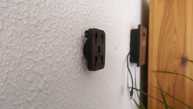

Posted mine earlier but wasn't satisfied with it.
The wooden frame prevented me to use the powerbutton incase i needed to reboot or in very dark light conditions the motion detection does not work.
There for i created a different wallmount.
I used a old phone car mount.
Removed the swivel section other wise the tablet would stick 10cm out of the wall.

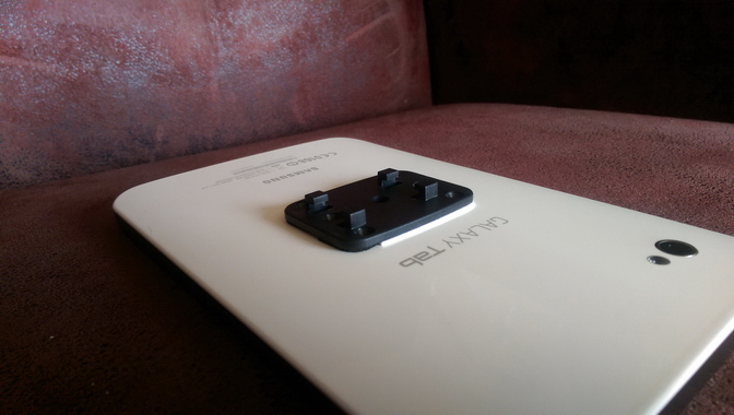

Drilled a hole into the mount section to be able to screw it to the wall.
Put some very strong 3M sticky tape on the back of the tablet to stick on the slider for the wall mount.
Only thing which is annoying me at the moment is the charging cable.
Hate to see cables ;-)
The cable is guided true the wall where the Thermostat cable goes true.
Behind the wall is the cellar with cupboard and there for the power supply.
