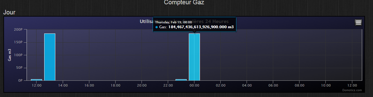

Hello Pierre.
I got some probleme using your sensor
look at my graph and numbers, it can be true.
conso gaz.PNG (100.26 KiB) Viewed 5767 times
What i can do ?

Did you use serial debugging to check if the pulses are detected ?
