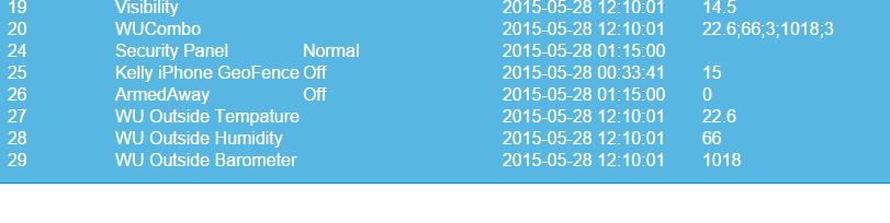

So my script 2 posts up to parse all the data (humidity and pressure) the script is working but I think there is a bug now..
I see all values in the events show current states screen but the virtual humidity and pressure are at 0 on the device tab and wacky on the dash

I have to say, I've tried many variations of these scripts and finally managed to get one to run properly without logging errors, but I get the same results as spudgunman above. The temperature scrapes and works OK, the virtual humidity sensor gets reset to 0 (and stays at 0), the pressure appears to work OK but i have the same dashboard problem as above.
I've tried deleting and recreating the virtual sensors many times but I always get the same results.

You have to change to script a bit for the humidity, see the last line from (a part of) my code below. I am not using it for the pressure, so I can't help you with that, but maybe it works the same way.
sWeatherTempwu, sWeatherHumiditywu, sWeatherPressurewu = otherdevices_svalues[sensorwu]:match("([^;]+);([^;]+);([^;]+)")
sWeatherTempwu = tonumber(sWeatherTempwu)
sWeatherHumiditywu = tonumber(sWeatherHumiditywu)

ok that helps a ton - i updated my script to work with humidity now.. all that is remaining is to figure out pressure and what it expects.. so far the same trick of using 1,2,3 gave funny results
--Script To Parse WeatherUnderground Multi-Value Sensor, Additionally using PWS: system from WU with a new output format
--This script assumes the output (which can be viewed in events show current state button) is like this 19.5;79;3;1019;3 (temp;humidity;null;pressure;null)
--more details at this wiki http://www.domoticz.com/wiki/Virtual_weather_devices
--The following need updated for your enviroment get the 'Idx' or 'Name' off the Device tab. By default only the Temp is 'uncommented or enabled' in this script.
local sensorwu = 'ChangeME' --name of the sensor that gets created when you add the WU device (and that contains multiple values like temperature, humidity, barometer etc)
local idxt = 999 --idx of the virtual temperature sensor you need to change this to your own Device ID
local idxh = 999 --idx of the virtual humidity sensor you need to change this to your own Device ID
local idxp = 999 --idx of the virtual pressure sensor you need to change this to your own Device ID
if devicechanged[sensorwu] then
sWeatherTemp, sWeatherHumidity, sHumFeelsLike, sWeatherPressure = otherdevices_svalues[sensorwu]:match("([^;]+);([^;]+);([^;]+);([^;]+);([^;]+)")
sWeatherTemp = tonumber(sWeatherTemp)
sWeatherHumidity = tonumber(sWeatherHumidity)
sWeatherPressure = tonumber(sWeatherPressure)
--parseDebug = ('WU Script Parsed Temp=' .. sWeatherTemp .. ' Humidity=' .. sWeatherHumidity .. ' Pressure=' .. sWeatherPressure)
--print(parseDebug)
commandArray[1] = {['UpdateDevice'] = idxt .. '|0|' .. sWeatherTemp}
--commandArray[2] = {['UpdateDevice'] = idxh .. '|' .. tostring(sWeatherHumidity) .. '|' .. tostring(sHumFeelsLike)}
--commandArray[3] = {['UpdateDevice'] = idxp .. '|0|' .. sWeatherPressure}
return commandArray-

Yes indeed using the code above, I've also managed to get the virtual Humidity sensor working and giving the proper values but just like spudgunman the Pressure value is still giving problems.
So far, I've created a virtual 'Barometer' sensor which appears in devices, I've setup the script to scrape the value for 'pressure' from WU and this runs without showing any errors. In the 'devices' tab, I can see that the value has updated and does show the correct figure, which, I assume, means that the scraping is working OK. However I get the exact same odd value in the Dashboard as spudgunman posted earlier.
It looks as if the dashboard code is expecting different data (or a different format) to what it is receiving. Oddly enough I tried creating a virtual generic 'Pressure' sensor, plugged the idx for this into the script and this worked properly. The only problem is that this sensor appears in the 'Utilities' tab rather than the Weather one.
I'm wondering if the issue is something to do with the forecast field. I've notice that the output from WU will be something like 1004 (the pressure value) followed by a forecast, wet for example. So might the Barometer virtual sensor be expecting additional data (which isn't being scraped properly so it just doesn't display correctly) - or maybe I'm just talking complete rubbish!
Any help or suggestions would be gratefully received.
