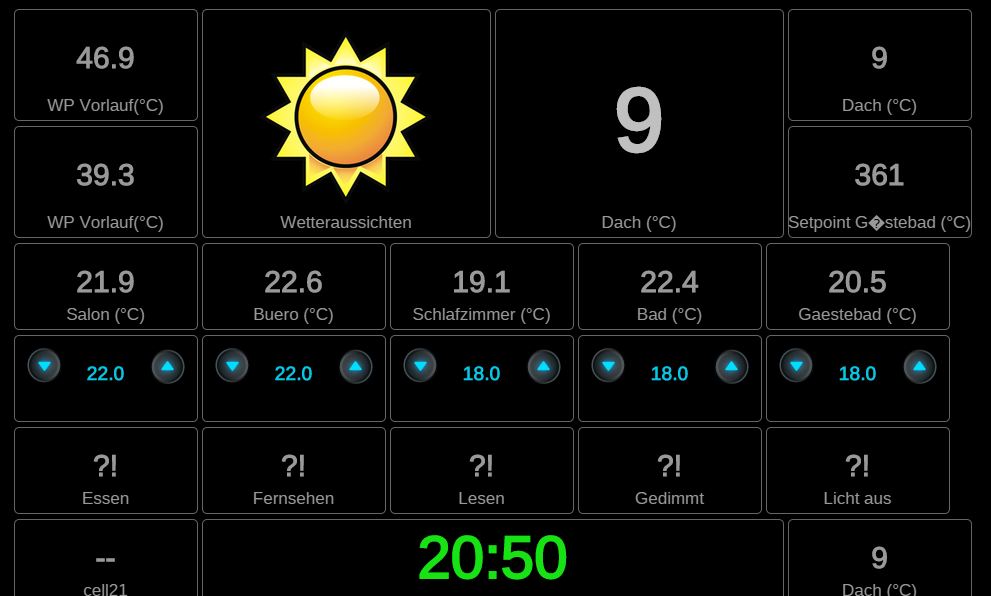

As you can see dimmers are used to set usable setpoints. As to convert the dimmer steps of 1/16 into usable temp values there is some math done, which gives me a variable " setpoint"
So I would like to have a dimmer cell where dimmer value is exchanged by setpoint.

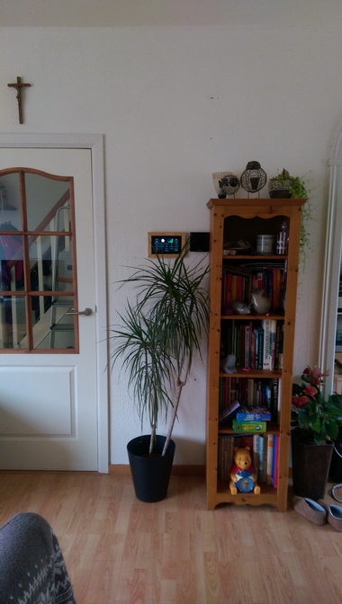

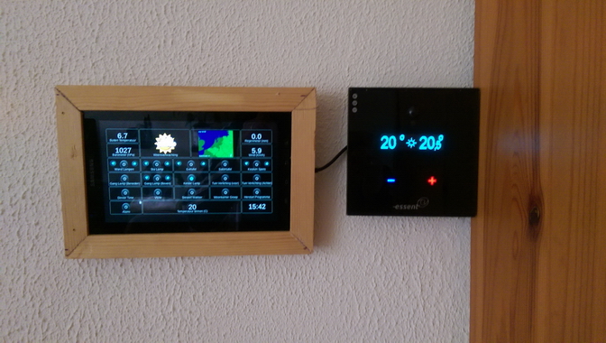

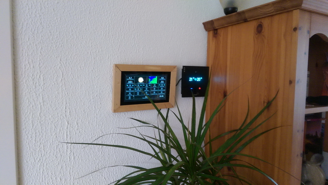

Wanna thank those who started this.
Had a old Samsung Galaxy Tab 7" eating dusk.
Last night i prepared it to run 24/7 with additional apps to beable to use Voice commands which is my next project to kill some time.
Today i made a wooden frame which only need some paint. ;-)
But here is my test setup...

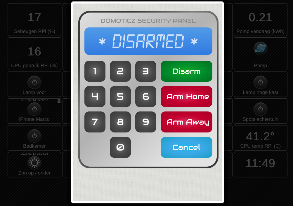

Have a question to those who know more about html in general.
In frontpage.html (dutch users) i/we have a cell with a Buienradar image.
<img src="http://www3.buienradar.nl/images.aspx?jaar=-3&soort=sb&t="  onClick="lightbox_open('camera2', 15400);" width="200px" onload='setTimeout(function() {src = src.substring(0, (src.lastIndexOf("t=")+2))+(new Date()).getTime()}, 15000)' onerror='setTimeout(function() {src = src.substring(0, (src.lastIndexOf("t=")+2))+(new Date()).getTime()}, 1000)' class='camera' />
When ticked it will open a popup with the realtime rain prediction.
Normally when you alter it you are able to open a other popup with a different content.
Well, this doesn't work.
For example i modified the line to be able to open the secpanel in a popup to arm or disarm the alarm instead of surfing to the desired page.
I have tried several modifications but non of them produces the desired popup.
Either it is opening nothing or it opens the "buienradar" popup.
I tried the following:
<a href="http://192.168.1.11:8080/secpanel/index.html"  onClick="lightbox_open('secpanel', 15400);" width="200px" onload='setTimeout(function() {src = src.substring(0, (src.lastIndexOf("t=")+2))+(new Date()).getTime()}, 15000)' onerror='setTimeout(function() {src = src.substring(0, (src.lastIndexOf("t=")+2))+(new Date()).getTime()}, 1000)' class='camera' />
<a href="http://192.168.1.11:8080/secpanel/index.html"  onClick="lightbox_open('camera2', 15400);" width="200px" onload='setTimeout(function() {src = src.substring(0, (src.lastIndexOf("t=")+2))+(new Date()).getTime()}, 15000)' onerror='setTimeout(function() {src = src.substring(0, (src.lastIndexOf("t=")+2))+(new Date()).getTime()}, 1000)' class='camera' />
<a href="http://192.168.1.11:8080/secpanel/index.html"  onClick="lightbox_open('camera2', 15400);" width="200px" onload='setTimeout(function() {src = src.substring(0, (src.lastIndexOf("t=")+2))+(new Date()).getTime()}, 15000)' onerror='setTimeout(function() {src = src.substring(0, (src.lastIndexOf("t=")+2))+(new Date()).getTime()}, 1000)' class='camera' /><img src="http://192.168.1.11:8080/images/security48.png"></a>
<a href="javascript:lightbox_open('http://192.168.1.11:8080/secpanel/index.html');"><img src="http://192.168.1.11:8080/images/security48.png"></a>
Can write anything down which i tried.
But can anybody point me in de right direction to be able to open a popup in the same style/layout but with the secpanel in it's place.

Interesting question, and I would love this implemented too. But first I have to understand how this sec. panel works and what it exactly does. I too want to expand the possibilities I now have to use an alarm system. I already have some doorsensors, but haven't gotten around to find out how this could be used for an alarm. If you or someone else finds the solution for the code, please post it here :) ? This would be an extra push for me to finally (...) find out about the alarm :)
Siewert308SW
Posts: 294
Joined: Monday 29 December 2014 15:47
Domoticz version: Stable
Post by Siewert308SW »
mvveelen wrote:Interesting question, and I would love this implemented too. But first I have to understand how this sec. panel works and what it exactly does. I too want to expand the possibilities I now have to use an alarm system. I already have some doorsensors, but haven't gotten around to find out how this could be used for an alarm. If you or someone else finds the solution for the code, please post it here :) ? This would be an extra push for me to finally (...) find out about the alarm :)
Basic is simple,
with the secpanel you can set the internal domo alarm variable with a pincode to arm or disarm.
With this variable you can obviously build a blocky.
I don't own a expensive alarm system.
And there for i use my 4 smoke-detectors.
Example:
When the alarm is armed and someone opens a door, window or motion is detected with one of my kaku switches then you have a 30seconds delay and be able to enter the pincode.
Other wise all four smoke-detectors will start to panic and i'll receive a message of a possible burglary.
The way it's setup now is that someone had to take his/her phone and disable the alarm.
This is something i want to prevent and want to be able to use the frontpage.html and assign a cell with lock image.
When pressed it should open a popup in the same style of the frontpage with the secpanel keypad.
Unfortunately the code as we know it now in the frontpage doesn't allow to open the secpanel html as popup.
Old style popup scripts do work on windows but android browsers don't and either open a new window or nothing at all.
I do find it weird why the current popup script is refusing this or if the secpanel is having a hardtime.
I just hoped some else already done this and there for asked for help.

These setpoints are set by their timers but I would like to manipulate them via frontpage.
I have seen that's possible but I'm mixed up with the different versions.
Who can me help out with a code?
Eventually I arrived here:
So I got my setpoints ( cells 11 - 15) visible but can not change them
I got my scenes ( cells 16 - 20) visible but can not switch them.
Where is help?

Yesterday I made a setup in which I had one cell with an alarm button. When you clicked on it, it would open a pop-up with the security panel in which you could enter the code. After you clicked near the pop-up, it would close the pop-up. Few downsides: the pop-up was missing the top of the security panel. Strange, but I couldn't get it the way I wanted it. Second downside: clicking on the background wasn't the way I wanted it. And third thing: when the pop-up opened, it firstly flashed a whitish pop-up and after that, the security panel showed. So I wasn't glad with the way it looked and deleted it again. Maybe I'll try again tomorrow....
mvveelen
Posts: 721
Post by mvveelen »
Unfortunately I wasn't able to edit my last post ?!
I now have a button for setting the Alarm. When I push the button, a pop-up appears and I can set the alarm. Haven't tested it yet on a tablet, but this is what it looks like in my browser (see attachment).
Things I still haven't figured out:
- how to add a description to this cell ?
- what idx could I use to show that the alarm is 'set' ? Because I would like to have a button that changes when it's 'set' or isn't.
(other tiny improvement: when the lights are OFF, the UP and DOWN buttons for the dim levels are also 'off' (=grey). Thanks ThinkPad for mentioning this to me.
Schermafbeelding 2015-02-13 om 11.49.39.png (279.39 KiB) Viewed 4742 times

mvveelen wrote:Unfortunately I wasn't able to edit my last post ?!
Look great,
You could add the secpanel widget and see what idx it has.
Your approach is different from mine or what i have in mind.
I'm trying to let the tablet screen show secpanel screen if armed and frontpage if disarmed.
But would love to take a sniff at your code.
