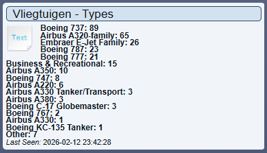

The names of the sensors are made up of 2 parts.
- The name you give to the plugin @install
- the name of the sensor
Example: I gave the plugin the name Vliegtuigen so the name of the Tracker sensor is Vliegtuigen - Tracker
The sensors are:
Tracker - displays the planes flying over your head
Counter - counts the planes flying over your head
Types - Counts the types of planes flying over your head
Screenshot 2026-02-09 150946.png (20.64 KiB) Viewed 79 times
When you click on the CallSign of an plane like KLM1844 or RYR9HN or BAW979 in de Tracker sensor, a new Airplanes.live tab opens in your browser and shows the plane on the map.
airplane - types.png (18.25 KiB) Viewed 47 times
This is a one day score within 9 miles from my house.
