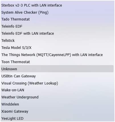

Hallo Waltervl and gizmocuz,
I run domoticz on window 10 machine as my Rpb4+ does not work anymore with this software 2025.2
I have to update my machine but weewx is also no longer running than.
Ihave the following list in hardware. (see enclosure).
73's
73's
