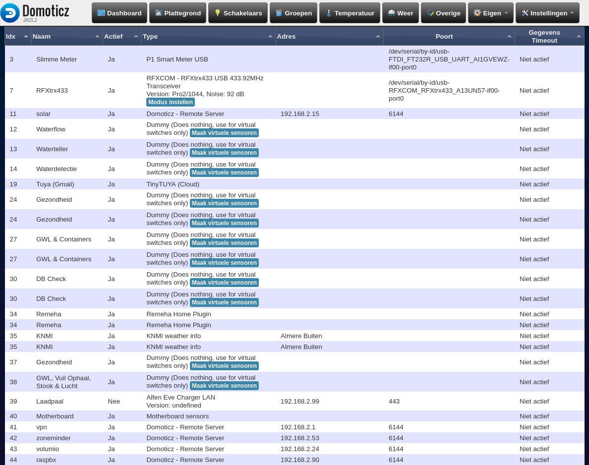

In my hardware list, a number of hardware types are listed twice (idx 24,27,30,34,35). They are completely identical. Is this s a bug, or can I adjust it myself or ....
Any tips or tricks are welcome to make my hardware list populated with unique hardware types.

Thanks for your tip! I pressed ctrl-F5: no change. I opened the page in private: no change. I also opened the page in chrome (I normally use Firefox) and also no change. Double checked in chrome incognito: no change.

If you see the double there too then you have an issue in your database.
If you do not see them in double in the json then it is browser related (javascript caching).
I just viewed the database, there are also doubles. I guess I'll backup the database and try to remove the double entries in the db. Scary .... I am not that much of a db goeroe
