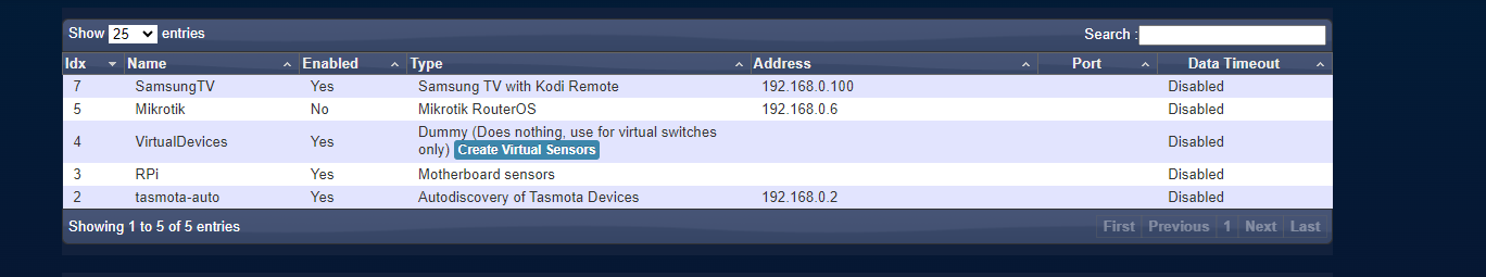

But I have problem with my own plugin. I had checked all:
permissions, owner, start in console with python (run without errors).
After restart of domoticz-service does not see any information in the log about plugins-initialization process.
I have did a mistake in the plugins code and restart the service again - no error messages.
can somebody explain me what I did wrong?

@walterw: what is it a "hardware gateway" and how need to add to the domoticz? Send please me a link to description of process if it present.
Posts: 6676
Domoticz version: 2025.1
Re: include my own pythons plugin in the domoticz
svd71 wrote: Monday 29 December 2025 12:41 @walterw: what is it a "hardware gateway" and how need to add to the domoticz? Send please me a link to description of process if it present.
That is in menu Setup-Hardware
See wiki for installing a plugin https://wiki.domoticz.com/Using_Python_ ... g_a_plugin
By the way, there is already a MQTT Tasmoticz plugin available:
viewtopic.php?t=21918

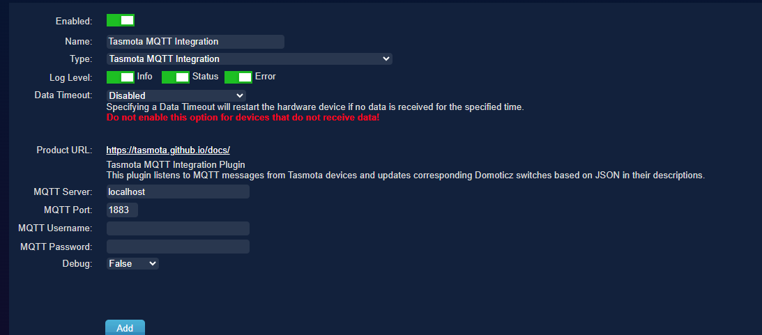

svd71
Posts: 16
Joined: Saturday 09 January 2021 17:58
Post by svd71 »
thank you very much!
I have it. But it is same question, why I did not see it in the menu "Hardware" for settings.
Posts: 6676
You first have to add it in the form below this list: https://wiki.domoticz.com/Hardware_Setu ... re_Gateway
svd71
Posts: 16
Post by svd71 »
Thank you very much!
I had found it !!!
