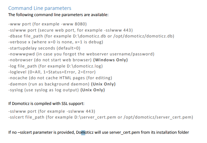

It is, but is the "-no-cache" a valid parameter? This is what the wiki states: https://wiki.domoticz.com/Command_line_parameters.
Isn't the "-no-cache" a parameter for your browser on your the computer?

Ah, now its working with this environment:
- EXTRA_CMD_ARG=-nocache
How stupid... :roll: :lol:
Posts: 6676
Domoticz version: 2025.1
Re: How to start Domoticz with --no-cache in docker compose?
And the nocache option was added in the code in 2023 but not documented in the wiki, now it is....
