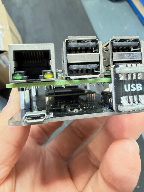

Why not just take an image of your SD card and write it to a mini msata drive and use an msata pi hat, you'll still have the really low power consumption of the pi and the reliability of a real ssd !
I have 3 x pi 3b+ running like this for years with out issue, also you have the added advantage that you can shut the pi down, unlug the USB loop and then plug the drive straigh into a pc with a USB cable and do full backup images easily.
Should look like this :-
pi 3b+ with msata.jpg (80.36 KiB) Viewed 211 times

Looks promising! But How to make a pi boot from that drive? Do you have a link to a supplier?

Just look up rpi usb boot for the 3b+ there is loads of documentation for this, as for the board Amazon maybe as they used stock it, Aliexpress still do and I guess ebay as well, obviously the pi3b+ is older now so add on hardware is becoming less popular.
Heres the how to USB Boot link for the card:-
https://suptronics.com/miniPCkits/x820- ... tware.html
and here is the card on Aliexpress
https://www.aliexpress.com/i/32965469328.html
you just need to add an msata drive to it and away you go.

I managed to enable the pi to boot from usb. checked it by moving the sd card to an cardreader of which the pi boots.
Then I wrote using pi imager an update to an external ssd I had hanging around. But the pi didnot boot. Any idea?
The board you pointed me to:
- is the pi powered from that board? Which voltage is required? which ssd is supported?
thanks for your help

Sorry for the late reply, had a busy few days. Not sure why your Pi would boot from a USB card reader but not from an USB SSD. I've never had an issue booting from any USB device providing (as HansieNL said) the OTP bit is set. The board for the msata ssd gets it power from the USB port so you power the Pi the normal way. To be honest though I've never powered my Pi from the micro USB socket, I either use a POE hat or I just power it directly from the GPIO header, Pin 4 is +5v and Pin 6 is Gnd or 0v. If your not too bothered about size and don't mind using a standard 2.5" SSD you could also use one of these:-
https://suptronics.com/miniPCkits/x820_v3.0.html
I have tried these too in the past and they work just fine, my only reason for the msata option was physical size, I have a number of 3b+ Pi's in a rack so needed the smaller form factor due to space. Hope you get this sorted, if you need any more help I'm happy to assist if I can.
