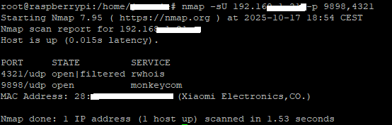

Domoticz is online, RFX is working, all my devices there. But no update from the Xiaomi gateway. The IP of the gateway still the same, also the password entered again, and no Xiaomi devices appears / no update on current Xiaomi devices ...
The 9898 still opened
Any ideas why ?
