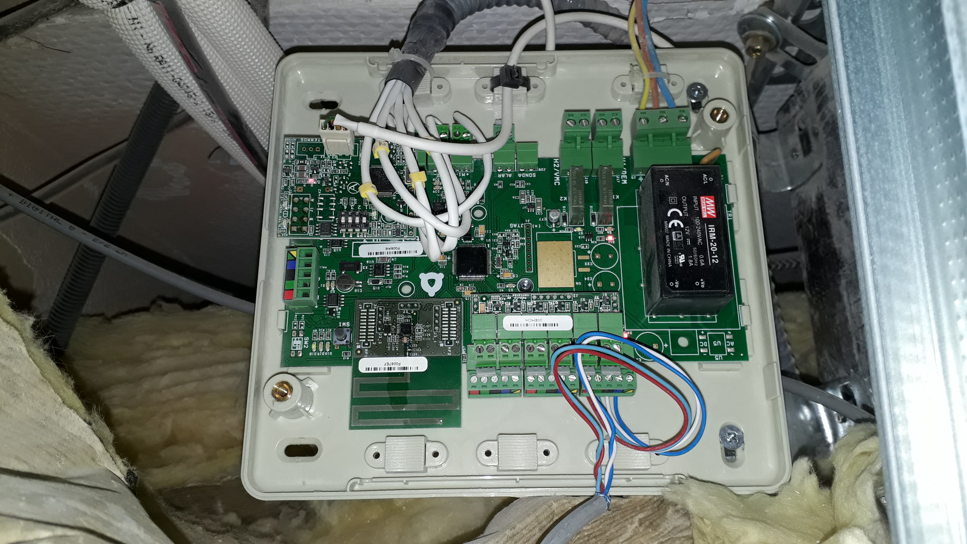

I forgot the main part
I think it's innobus-pro6
http://myzone.airzonefrance.fr/produits ... 6-201.html
Here's a picture
Here's a picture
multinet
- Posts: 97
- Joined: Friday 05 December 2014 22:52
Re: AIRZONE and DOMOTICZ (poll)
hello
It seems to be compatible
Are you aware with wiring relay board to gpio ?
Multinet
Multinet

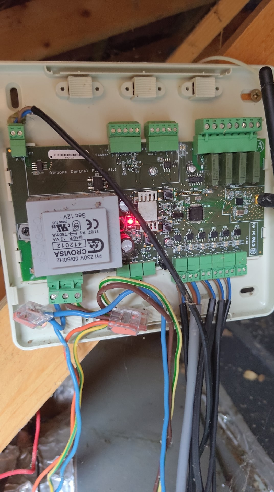

Hello. I have a Flexa 1.1.
Do you think it is compatible ?
