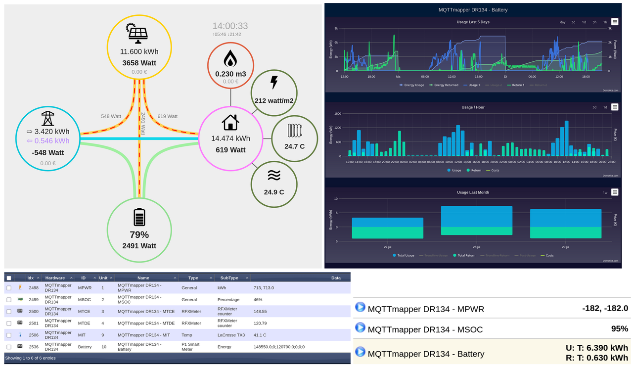

Have a modbus device like the Homebattery Marstek Venus V2 5,12 Kwh and want a direct connection not using the API ?
No more waiting until data synchronize or wondering where the data went.
Like this ?
With just a few minutes of your time, a few easy steps and and only 108 configuration lines in just 2 .json files !
You can find my project on Github : https://github.com/RneeJ/Domoticz-Marstek
More is easy possible, even controlling the device, also for other modbus devices, having a rs485 port, that store data in registers.
(you need the manual for these register#)
With only the use of the PUSER-DR134 (a € 15 device) and MqttMapper plugin (by Flyingdomotic) you can bypass programming, api's etc.
Thanx to Waltervl (who told me to report here) and Flyingdomotic for helping !

Well, it worked for me flawless since july 2025.
I run always in NOM mode, self-consumption, and the reporting works the way i need it. I have no need for controlling the Marstek from Domoticz.
I made some automated warnings like a high temperature warning over telegram.
If you like you can add more reporting registers from the mentioned github page to the DR134. i can add some for you in the .json configuration. Just tell me.
Controlling the Marstek Venus needs more study, but i think it should be possible wth the DR134 and mqttmapper.

Henielma wrote: Monday 29 September 2025 21:49
eddieb wrote: Monday 29 September 2025 21:14 Can you please post de DR134.json and the mqttmapper.json you used ?
See the attachment. DR134 (1).zip
Do not forget to change in the Domoticz Devices 'MQTT mapper - MTCE' and 'MQTT mapper - MTDE' the divider into 100 to get these values in kWh with two decimals.
Furthermore I changed the following Edge gateway settings but this is for your own choice:
Poll intervall 9000
Reporting interval into 60
This because the very fast update is not needed for my application. And the more quite Modbus gives more opportunity to send commands to the Marstek using the EspEasy.
I added the 2 extra devices you are using but the batteryPower you read on 32102 gives me a totally different value, it never reads more than 1000W while it charges to 5.12kw ... Are you using a Venus E2 or an other model ?
RPI4 Beta / Tasmota / ZigBee2MQTT / P1meter / Haier AC MQTTmapper / SolarEdge SE3500H modbus_tcp / IndeVolt SF3000 / Opentherm gateway / Plugwise Anna/Smile / ObserverIP weatherstation thru WuDirect
Feeding ADSB https://adsb.im/home
Henielma
Posts: 13
Joined: Friday 12 September 2025 12:14
Domoticz version: 2026.2
Re: Easy modbus solution for Marstek home Battery
Post by Henielma »
These sensors are about power not energy.
The maximum power of the Marstek Venus E2 is 2500 Watt
The maximum energy that can be stored is 5.12 kWh (kilo Watt Hour)
