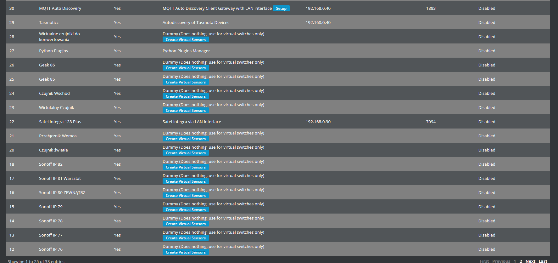

You have only 1 such an interface configured?
YES
Can you show me the configuration.
YES
Hardware:
I recommend to you, to install MQTT Explorer on your desktop or laptop, so that you can check what happens in MQTT.
I have it installed on my computer but everything runs very quickly because there are so many devices.

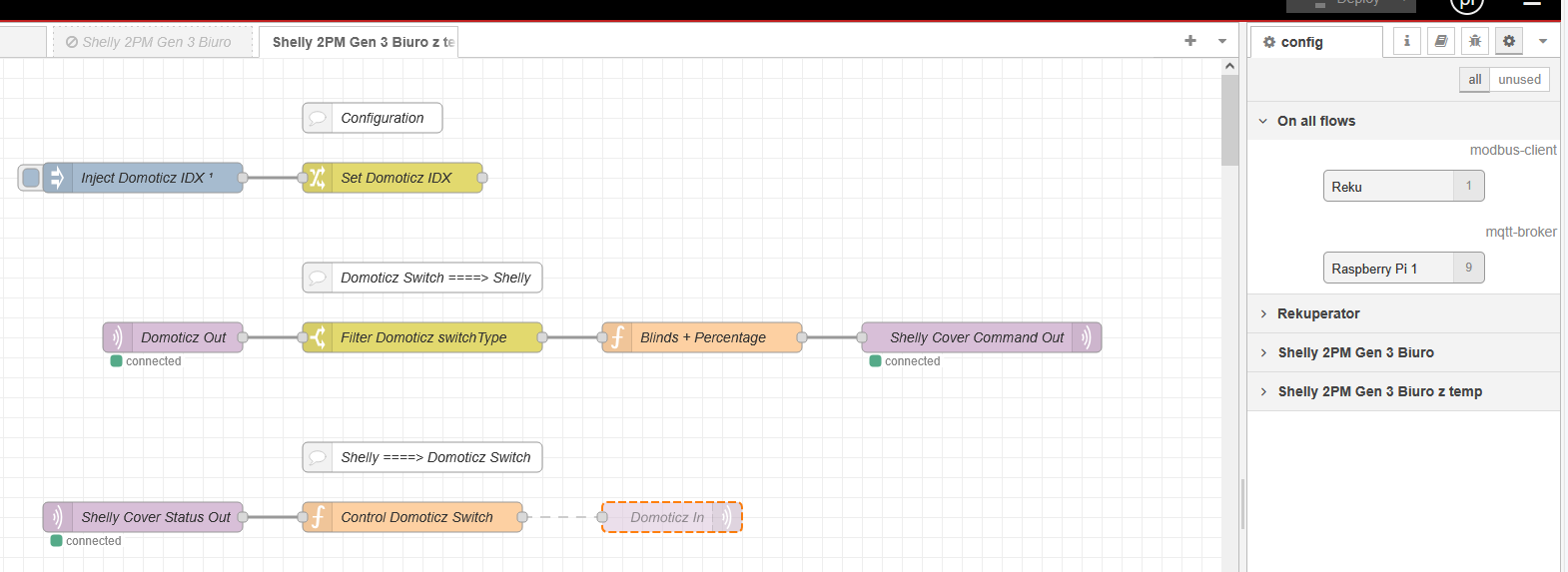

However, there is something wrong with this flow with temperature, because if I turn it on, the dashticz stops working stably - I click on the light bulb icons and they don't work.
I turn off the flow with temperature.
I turn on the flow without temperature and the dashticz returns to working properly.

Can you try, if it happens, not to disable the whole "flow", but only the MQTT Output node, marked "Domoticz In"
(Also a button down left) and "Deploy"
Yes, now I see that you wrote it.

Exactly as you wrote, disabling the "domoticz in" node itself in the flow with temperature restores the system to operation.
I noticed the problem in operation after domoticz performed automatic closing of all blinds. Automatic closing is performed by a scene in domoticz.

Very strange, but to test, I have modified the "Function" node, so that the Temperature will not be sent to the MQTT Output.
Can you put this node in parallel with the existing "Function" node and disable the existing "Function" node (down left button).
Enable the MQTT node again and test.
        "id": "58eeb2cbc12d887e",

So here we go with test.
I changed the name - I added the word TEST.
I think that's what you meant.

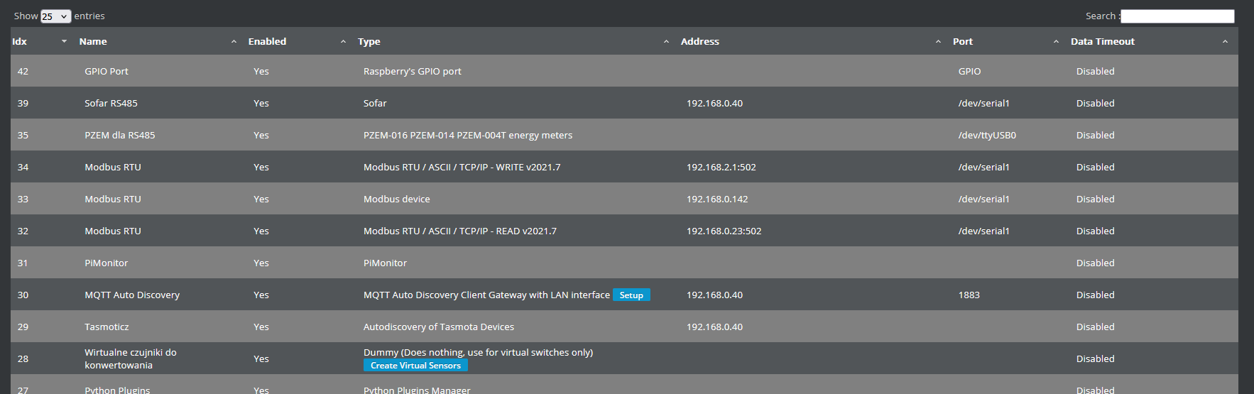

And the, I want to check the following in the settings of the MQTT
1. Go to "Setup" ====> "Hardware"
2. got to MQTT (your Id = 4), called MQTT Client gateway with LAN interface.
3. What is your configuration of "Prevent Loop"? Let me know.

I looked to your both posts
Your MQTT configuration is okay. The "Prevent Loop" configuration has been set to "True".

And test again. For the time being, leave the "Debug" node in place.
You said also:
But NOTE:
Although I turned off two nodes as in the post, in the morning the lighting no longer worked from the sensors, after turning off the entire flow, the lighting started working and has been working until today. The roller blind is controlled from the flow without temperature and everything is ok.
I do not understand that, as the "Function" node and the "MQTT Output" node were already disabled.
By disabling the whole flow, you disabled the stream from Domoticz to Shelly and the MQTT Input node in addition.
Or!
Do you have also flows with the Shelly nodes (http) active in some way. that those create the loop?
Let me know.

After recent tests I think that:
If I turn on the flow with temperature:
Dashticz immediately stops working.
If I use a scene in domoticz:
Lighting stops working, i.e. another communication fails.
FireWizard

Did you already test with the 2 nodes, I sent you?
YES:
Unfortunately it doesn't work.
Communication is down.
- Dashticz stops working.
- Lighting from sensors also - in this case new domoticz settings turn on the switch but there is no communication to Sonoff for Sonoff to turn on the bulb.
