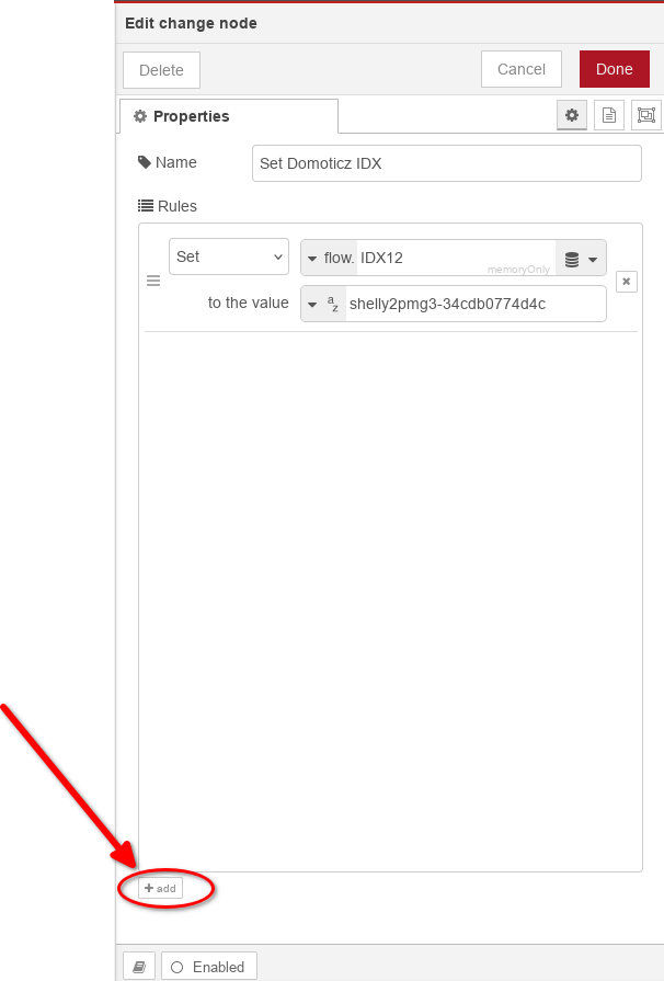

Hello @Daro1003,
I don't know how to do it ;/ Can you upload a screenshot?
1. Open the "Change" node, called "Set Domoticz IDX", by double clicking.
2. Click the +add button and another field will be added.
3. Add the Domoticz IDX and the Shelly ClientID in the same way as the first item in the node.
4, Deploy
5. Activate the "Inject" node.
I recommend to view some videos of Node-RED: https://www.youtube.com/watch?v=jMaHKQLXYhI

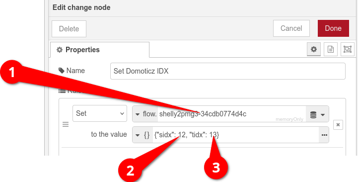

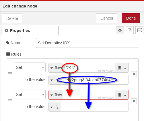

To make the configuration as simple as before, I had to swap the key and value.
Previously the key was the characters IDX followed by de Domoticz idx number, e.g. IDX1060.
The value was the Shelly ClientID
I swapped those 2, as shown in the next picture
Screenshot_Shelly 2PMG3-alt.png (46.94 KiB) Viewed 1747 times
1. The Shelly Client ID has to be inserted after flow
2. The Domoticz idx for the Switch has to be inserted in an Object after "sidx". Example 12
3. The Domoticz idx of the Temperature sensor has to be inserted in the same Object after "tidx". Example 13
The contents of the "Function" nodes has also changed.
Do the following:
Create a (new) virtual sensor for the Temperature of the Shelly device. Insert the idx number after "tidx":
Do not forget to configure your own MQTT parameters.

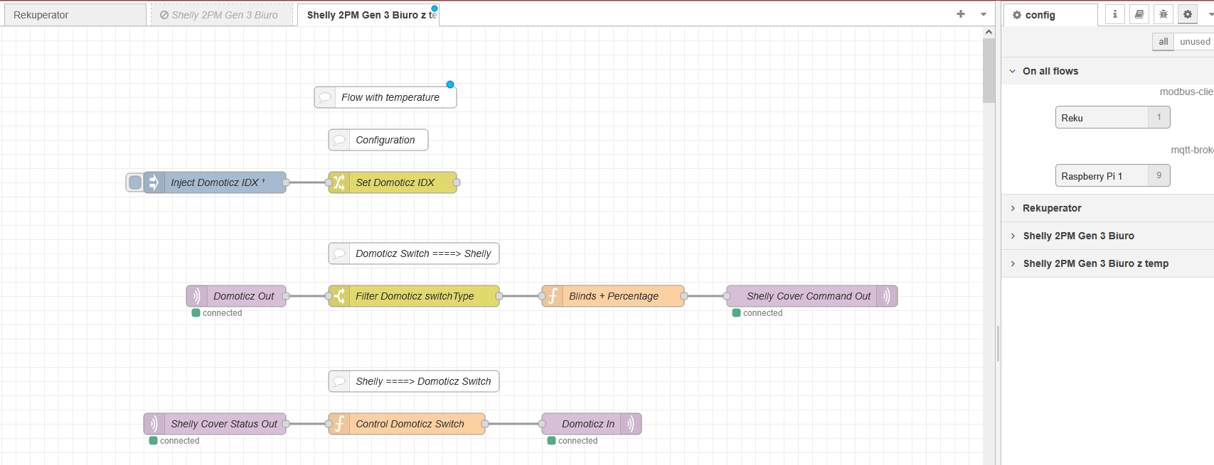

A complete flow you will find below.
I suggest you copy this one in a separate tab and disable the old tab.

Test it and let me know.

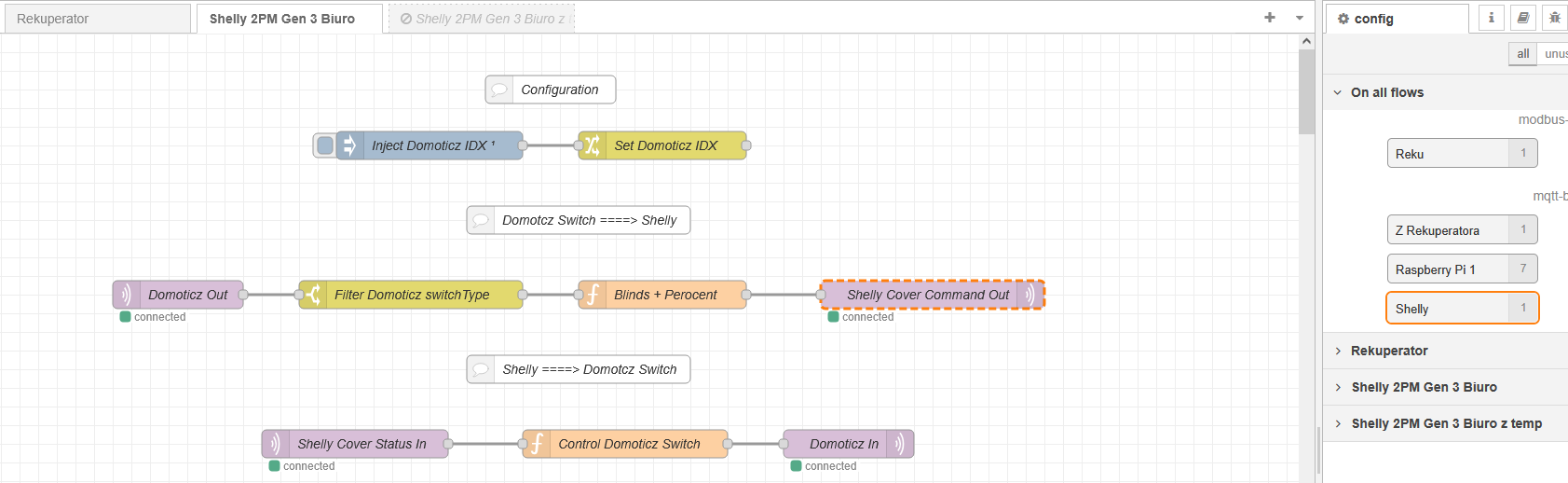

It turns out that the topic is still relevant.
When using the last flow with the temperature sensor, it turns out that this flow introduces some interference into the operation of other devices controlled by domoticz.
I noticed that the lighting control, which is implemented via the PIR motion sensor and Sonoff - communication via MQTT, does not work.
Motion sensor -> Satel Integra -> Satel plugin -> AFE Sonof 4ch

Hello @Daro1003,
That's okay for me.
and
After turning on the flow without the temperature sensor, everything works ok.
These 2 are the same?
I don't think it is related to the flow.
You did not mix Domoticz idx numbers?
The only relationship between this Motion sensor and the Shelly device is that they both use MQTT.

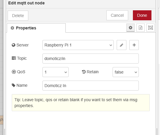

Can you compare the configuration of the MQTT output nodes, regarding QoS and Retain of both MQTT nodes (with and without Temperature)
See also: viewtopic.php?p=323871&hilit=Daro1003#p323871
Let me know.
Daro1003
Posts: 193
Joined: Monday 14 November 2022 12:46
Domoticz version: 2023.1
Location: Poland
Re: Is it possible to add Shelly 2PM GEN 3 to Domoticz?
Post by Daro1003 »
I returned to the topic yesterday.
I checked the settings - everything is ok.
IDX-ynie pomylone.png (12.46 KiB) Viewed 1530 times
The only difference is that in the temperature flow there were "debug" nodes - I removed the debug nodes.

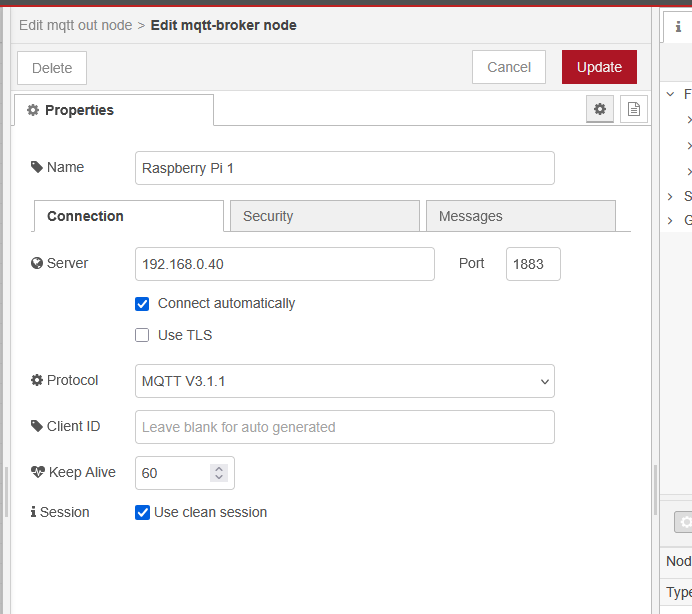

If you look to your second picture, you will see that the name of the Server is "Raspberry Pi 1".
That is exactly the name of the server in my test configuration.
You told me once, that your Domoticz and your Mosquitto MQTT broker run on the same hardware, and that is probably
not a Raspberry Pi 1, as Domoticz abandoned the Pi1 (armv6) already a long time ago.
In almost every post (and sorry, not the last one), I returned to you, I said:
So, if you configure your own MQTT parameters it will work for all devices that communicate by MQTT.

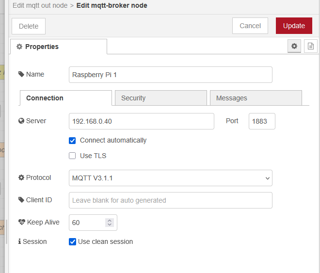

Everything is on Raspberry PI 3B+ and the server name is just the name of Pi 1 where the number 1 was supposed to mean the configuration ordinal number, I have never even had a Raspberry P1 in my hands.
In both cases with and without temp the server name is the same.
Without temperature:
Respberry Pi1 bez temp.png (26.88 KiB) Viewed 1493 times
with temperature:
Respberry Pi1 z temp.png (29.29 KiB) Viewed 1493 times

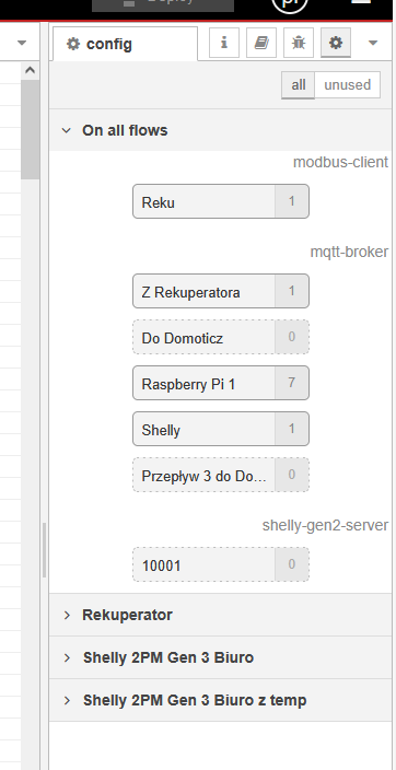

2. How many MQTT config nodes do you have (Check the "Hamburger" menu and then "Configuration nodes") for "mqtt-broker"?
3. Can you disable the MQTT nodes, marked "Shelly Cover Status Out" and "domoticz In" and test your Lighting?
4. Does the Tasmota device to Domoticz also use Node-RED?

2. You have 5 configuration nodes, but, I assume, you have only one MQTT broker (Mosquitto) installed on the same RPi3+
with IP address 192.168.0.40.. Am I correct?
If so, I recommend to delete the unused Configuration nodes. that are the one with "0" behind it and with the name "Do Domoticz" and
"Przeplyw do Do..." Then there remains 3. What are the other 2 (Z.Rekuperatora and Shelly) doing?
Do they point to the same broker? If yes, change that and remove then to 2 (now) unused configurations.
That makes it much simpler and clearer.
YES - only one broker installed on the same raspberry as Domoticz IP 192.168.0.40
"Przeplyw do Do..."
Nodes removed.
In NodeRed I have only two flows.
1. Recuperator - Domoticz
2. Shelly - Domoticz.
Which nodes should I remove? To avoid breaking something??

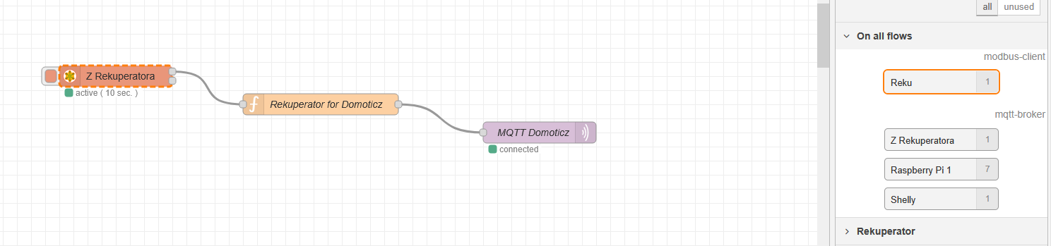

1. See you picture, marked as "Reku-Domoticz2.png"
Edit the MQTT output node, marked "MQTT Domoticz", by double clicking on it.
Change the name of the server from "Z Rekuperatora" to "Raspberry Pi 1" (click on the "down" arrow).
The config node shows "0".
Test it!!
If it works you may want to delete the config mode, as you did before with the other 2.

3. See you picture, marked as "Shelly-Domoticz2.png".
Edit the MQTT output node, marked "Shelly Cover Command Out", by double clicking on it.
Change the name of the server from "Shelly" to Raspberry Pi 1 (click on the "down" arrow)
Test it!!

Managed to clean up in NodeRed:
The photo shows three flows:
1. Vents recuperator - Domoticz active flow
2. Shelly PM2 GEN 3 - Domoticz without temperature - not active
3. Shelly PM2 GEN 3 - Domoticz with temperature sensor - active on.

hello @daro1003,
MQTT Client Gateway with LAN interface.
You have only 1 such an interface configured?
Can you show me the configuration.
I recommend to you, to install MQTT Explorer on your desktop or laptop, so that you can check what happens in MQTT.
