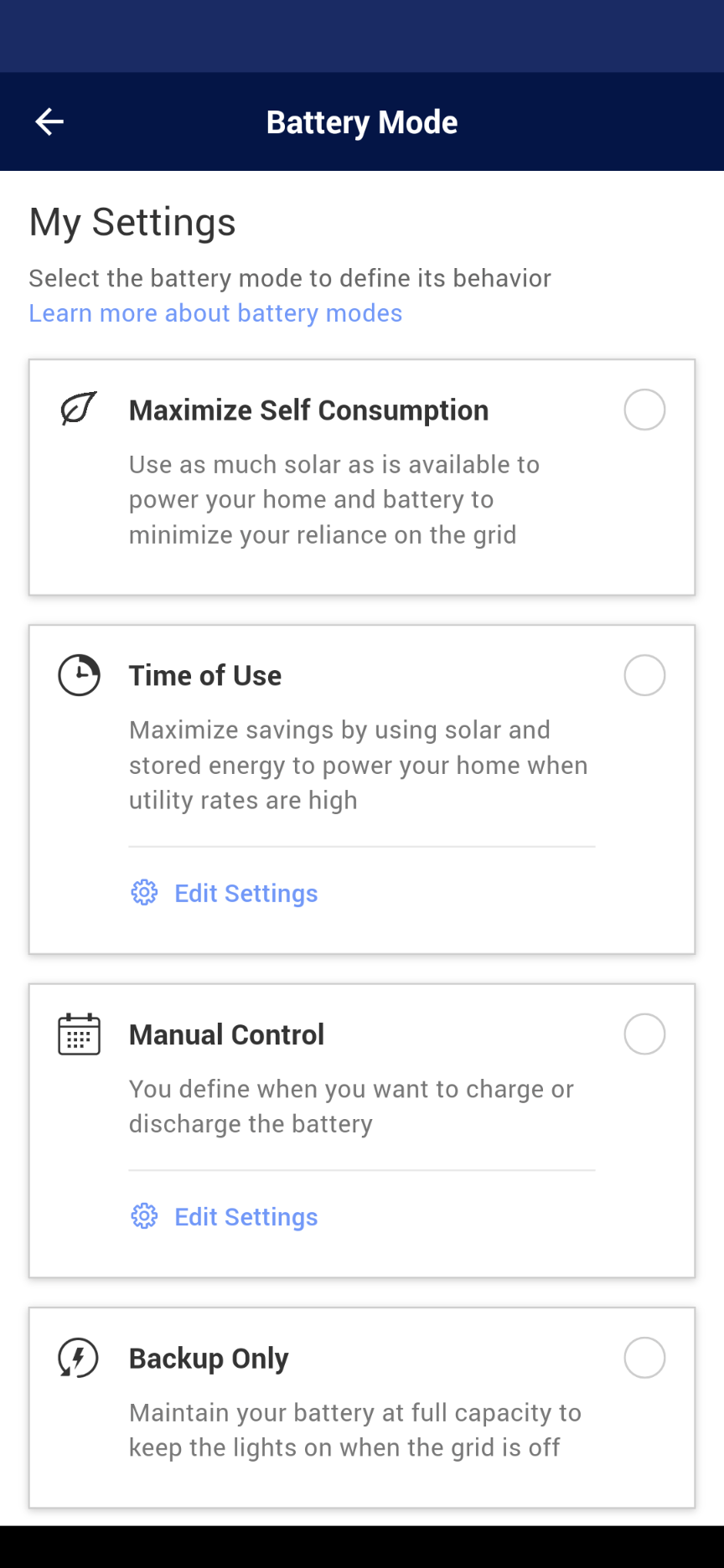

See Screenshot of the Option for Charging attached. And these are the explanations (haven't worked with this for the time being):
Battery Modes Information
Maximize Self Consumption
Go green and use the maximum solar available to power your home, charge your battery and minimize grid import.
Time of Use
We use a smart algorithm to optimize your energy sources based on your consumption habits, current and predicted energy output, and weather forecasts, to reduce your energy bills if you have different rates on different times. During manually configured peak hours or hourly dynamic prices your home is powered by solar as a first choice, by the battery as the second choice and by paid energy from the grid as the last resort.
In addition, based on your utility and installation settings, your battery can be charged from the grid, or energy sold to the grid when export rates are high.
Learn more
Manual Control
This mode allows you to set start and end times for charging and discharging your battery. You can set these schedules be recurring. All other time, the system operates to maximize self-consumption.
When a charging schedule is in place, the battery would charge from solar if available, and from the grid if allowed. Charging stops when the battery is full or when you reach the end time. During that time, the battery would not discharge itself.
When a discharging schedule is in place, the battery would discharge at full capacity, to provide for the home consumption and export energy if allowed. During that time, the battery would not be charged from the grid, it could only be charged from solar if it is available and it is not consumed by the house.
You can set multiplue charging and discharging schedules, as long as they do not overlap.
If you have high export rates at a certain hour, this mode could be utilized for monetization. You should set a charging schedule that ends when the high export rates begins, and set a discharging schedule for that time.
In addition, if you want to charge your EV during low-rate hours and make sure it does not use the battery, you should set a charging schedule for that time and the battery would not discharge itself.
Backup Only
Preserve energy sources and provide you with longer backup coverage time, while automatically reducing consumption to preserve battery energy. With this profile, the system will turn off any non-essential SolarEdge controlled device to preserve battery as outage starts.
Time of Use
Learn more
Manual Control
Backup Only
- Screenshot_20250617-100319.png (192.33 KiB) Viewed 7298 times

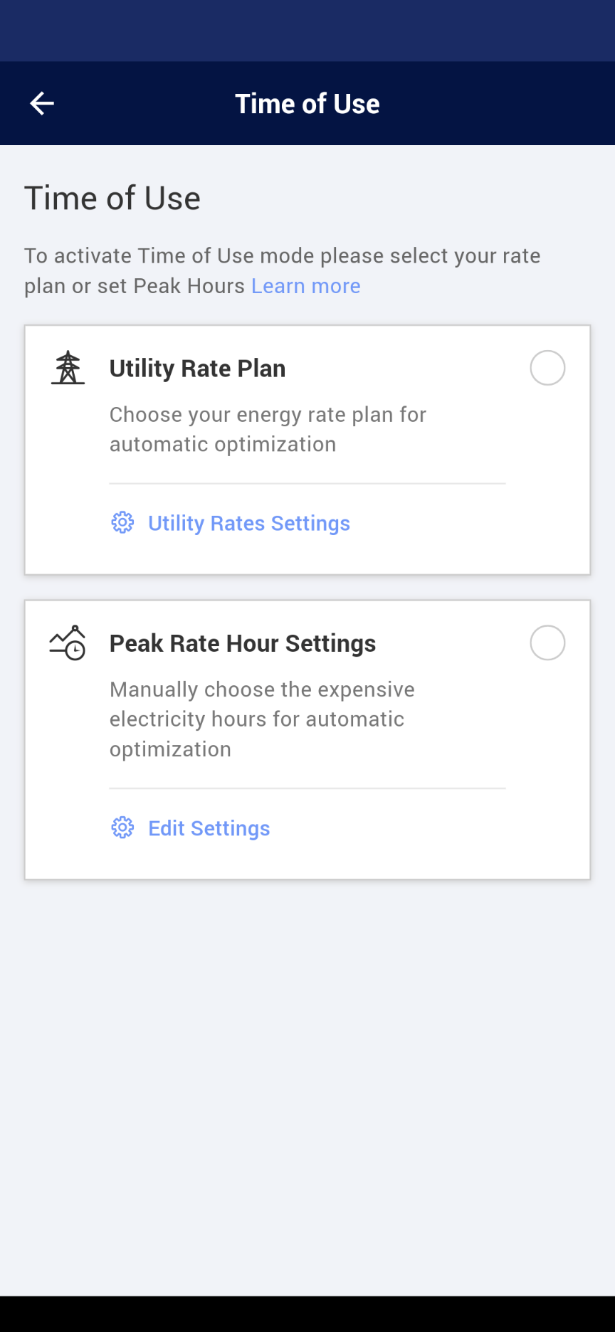

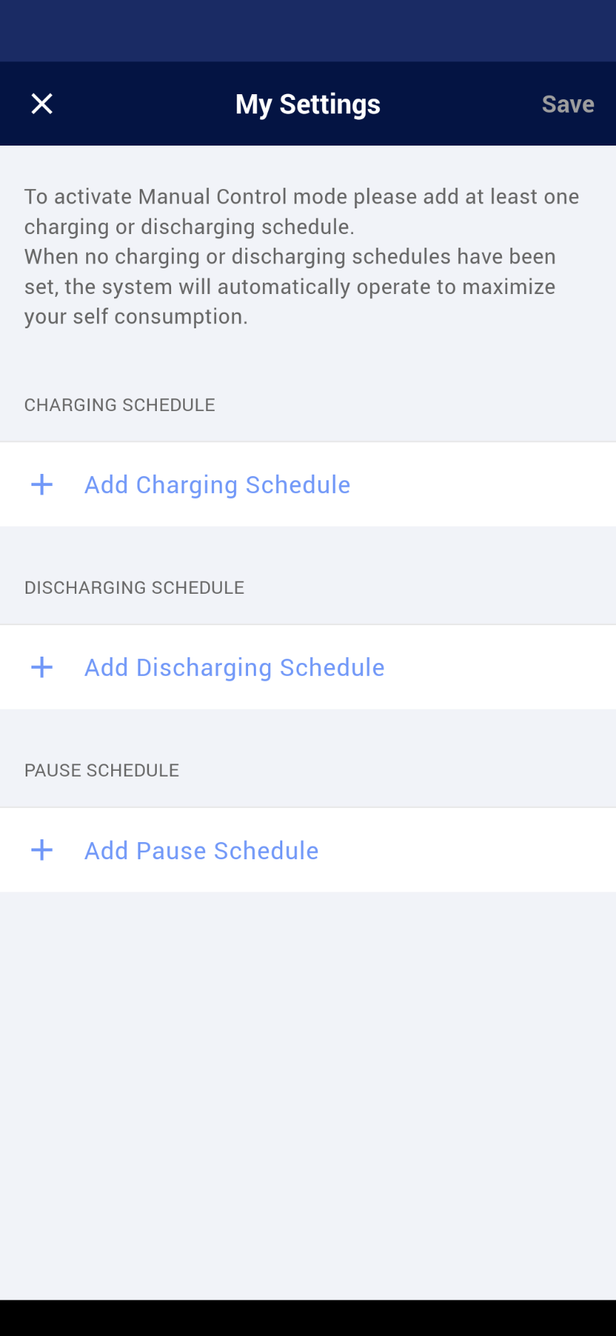

Only "Maximum self consumption" and "Backup only" makes sense for a pure selector switch. The othe options deman separate adjustments (see screenshots)
- Screenshot_20250617-101835.png (124.16 KiB) Viewed 7292 times
- Screenshot_20250617-101903.png (126.52 KiB) Viewed 7292 times
