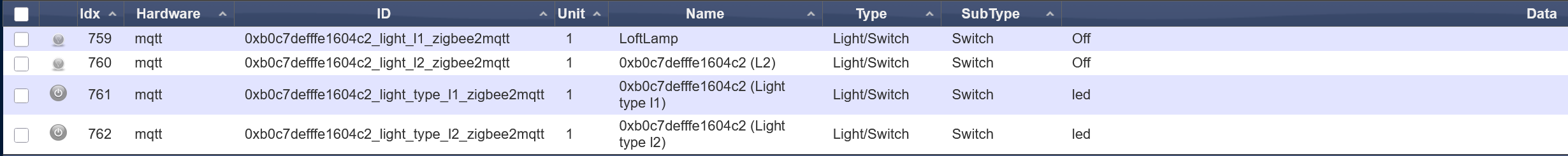

Thanks, good point. Domoticz 2025.1 and Zigbee2MQTT 2.4.0.
I dont see any new devices, all the devices discovered are below. I made device re-discover/re-join recently while i was trying to resolve the issue
I don't use the dimmer often, but i suspect the issue started post Zigbee2MQTT upgrade.
