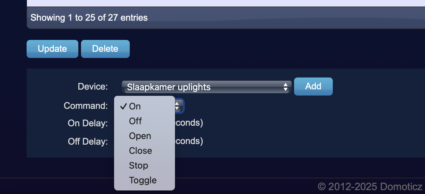

Is it possible to add a 'ON for x minutes' in Scenes?
I use it often in DzVents, but unfortunately not available in the scenes.

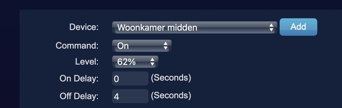

Hmm... meanwhile found out that it is already possible in Scenes!
Switch on and fill out the number of seconds at 'Off delay'.
Scherm­afbeelding 2025-06-01 om 21.43.38.png (86.4 KiB) Viewed 956 times
Then it switches on, and off after x seconds. Thanks.
