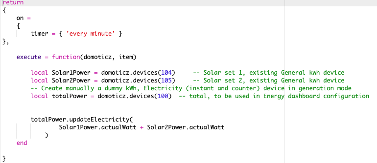

But I made this from another piece of coding and adapted that to my needs. So the solarpower plus a zero device is now totalpower which shows up in the energy dashboard.
And I have total today also.
But I have 2 same scripts now, one with "current and one with "today"
I think this coud be running in one script but I have to figure that out.

If you are filling the right data to the general kWh device totalPower you can delete the other 2.
It will also calculate the daily production for you but it needs a running total counter and not a daily (resetting to 0) counter.
You probably have to add JSON value "total". Please check if that total counter is increasing the same as the "today" value. It will help you a lot if you do this.
