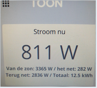

Can you post a screenshot of your Toon user interface where it shows the Solar data?
And all in W is strange....

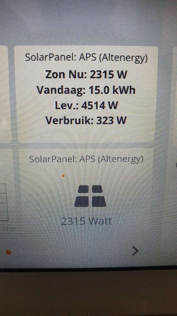

- Posts: 7020
- Domoticz version: 2026.3
Re: need help dzevets script solar Toon
So what are the json values from? Seems to be the one with 811W
Those values cannot be put as is in a Domoticz device. That is a function of the Energy dashboard.
Also the second screenshot seems strange for me.
Solar now 2315 W
Total 15.0 Kwh (so not all values are W
But what is:
Delivered 4514 W
Usage 323 W
I cannot map these values to solar panels. What do they mean?
Solar now 2315 W
But what is:
Delivered 4514 W
Usage 323 W
Wiers
- Posts: 23
- Joined: Tuesday 29 October 2024 12:03
"Stroom nu" is the same as "zon nu" and is the "current" value in the json.
They are different because there are clouds passing by.
this is the actual solar production of my panels in W.
the other values are not important.
I just want this number refreshed in a virtual counter if possible.

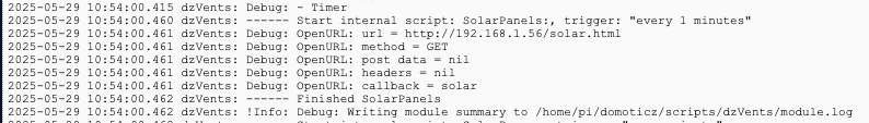

Wiers
- Posts: 23
One step further and without error but unfortunately without data.
I now have this script called "SolarPanels"
timer = { 'every 1 minutes' },
httpResponses = { 'solar' }
if (item.isTimer) then
domoticz.openURL({
url = 'http://192.168.1.56/solar.html',
method = 'GET',
callback = 'solar'
elseif (item.isHTTPResponse) then
if (item.ok) then -- statusCode == 2xx
local current = item.json.solar.current
domoticz.log(' current = ' .. current, domoticz.LOG_INFO )
It runs without errors but I also think without data.

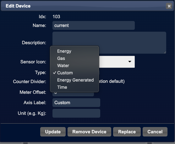

- Posts: 7020
What do you expect to see? Because you now selected a counter that needs the total kWh data field and not the usage data in Watt.
You can also create an Electric (instant and Counter) device. That needs 2 values. The current in W and the total counter in Wh. (But what is the correct values from the JSON, value total?)
You can also create a Electric Usage device that only needs the Watt values. No historical report on this device.
Be aware every type of device needs a specific update command. See the dzvents wiki.
