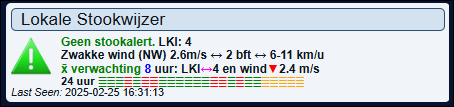

At the end of the day, I have changed the character used for the colored bar and show the amount of hours chosen.
I think that 24 hour is the most usefull. More hours is not only more unreliable, but also ugly when the line breaks.
Also a little bit rearranged the code.
I think I will keep this for a while and see how it works.

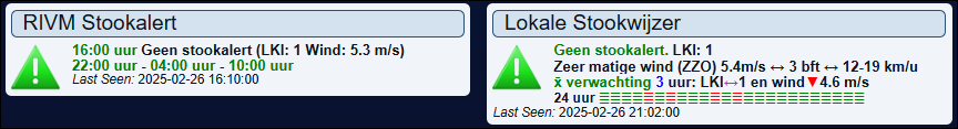

I have made some huge changes and made the whole setup even more configurable.
It can be set up the way you want. I will show you a few examples of combinations you can make here.
Major changes.
1. You can choose to show the full windtext or shortened (only direction meter/second and then added to the first line.
2. You can choose to show the forcast value AT the time of setpoint or the average UNTIL the time of setpoint.
3. Dynamic setopint calculates until midnight, but now you can override this by triggering the script by a change in setpoint to look further ahead.

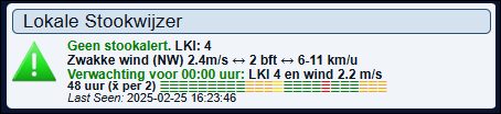

4. I have further developed the idea of ​​the footer. I believe that the insight per hour says more about the development over time than just the average over a period. To save space the footer with colored blocks shows 1 hour in a block up to 24 hours.
Up to 48 hours the average per 2 hours in a block and up to 72 hours the average of 3 hours in a block.
5. You can choose to show or omit the forecast text or footer or both as desired.
6. With useSetpointForFooter you will get the same number of hours in the footer as sets in the forcast with the dynamic or fixed setpoint.
7. Maximum number of hours you can get is 72 hours over 3 days starting at 00:00 hr. So the maximum you can use is 72 minus the hours that passed already today. The script adjusts the number of wanted hours to what it can use.
Here a few examples of these combinations.

footerHours = 48 (average 2 per 'block')
useSetpointForFooter = false

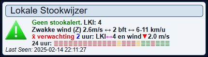

windTextLong = false
useForecastText = false
footerHours = 24

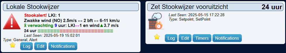

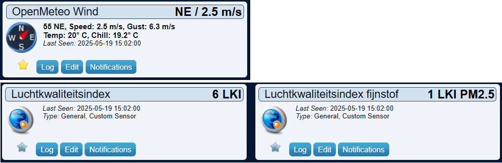

Also I did not uinderstand the much lower LKI in the new RIVM output.
But on https://iplo.nl/thema/lucht/houtstook-stookwijzer/ where the new criteria are mentioned it becomes clear that they use 'LKI-PM2.5'.
I have to understand this as the LKI value, that comes exclusively from the PM2.5 concentration!
Confusing that they keep calling this LKI. because earlier the LKI was based on ozone and PM10 and PM2.5 and nitrogen_dioxide, where the highest concentration thereof determines the LKI value.
See See https://www.rivm.nl/bibliotheek/rap ... 4-0050.pdf (§6.4, Table 7).
I think I can consider this as a clear explanation for the difference noted.
Where before I almost always saw an LKI of 4 or 5 and occasionally 3, I see it now almost all the time at 1.
I thought I will give it a try.
For who thinks it is better to use the new criteria I added the new definitions in the script.
You can choose between them for your own location by setting
local useNewRIVMcriteria = true     -- Use the new criteria found on https://iplo.nl/thema/lucht/houtstook-stookwijzer/
                                    -- and https://www.rivm.nl/nieuws/nieuwe-criteria-stookwijzer-op-basis-van-overlast
The calculation that is used then:
Green (actually yellow): windspeed >= 3.4 and LKI-PM2,5 <= 3
DarkYellow for PEPS override mode when LKI-PM2,5 is 4,5 or 6 (actually orange), but Windspeed configurable at acceptable >= 5.5
Orange: Windspeed >= 3.4 and LKI-PM2,5 is 4,5 or 6
Red: Windspeed <= 3.3 or LKI-PM2,5 >= 7
And see: Now I also have a low LKI (pm2.5)

--- Your settings ----------------------------------------------------------------
-- First set the used device index numbers and variables you might want to change.
local meteolki_idx = 99999	-- idx of your custom sensor 'Luchtkwaliteitsindex'.
local meteolki2_5_idx = 99999	-- idx of your custom sensor 'Luchtkwaliteitsindex fijnstof'
local meteowind_idx = 99999	-- idx of your custom meteowind sensor
local sa_setpoint_idx = 9999	-- idx of your custom setpoint device.
local useDynamicSetpoint = true -- True = Limit forecast until 00:00 hour and use setpoint when changing. False = Use Setpoint only.
local useSetpointFor = 'average'    -- set to 'average' or 'value'
local useColoredFooter = true   -- false = Off; true = On. To show colored footer for next footerHours hours.
local footerHours = 24       -- (Coded here) How many hours forecast in footer.(showing <=24 = value per hour, 25-48 = avg per 2 hour, 49-72 = avg per 3 hour.)
local useSetpointForFooter = false   -- Overrule footerHours and use the setpoint also for the footer.
