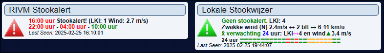

Here I show the approach with my modified DzVents script:
- Starts with calculating a boundery box around the latitude and longitude coordinates found in Domoticz settings.
- Gets the last known json information.
- Detects level, LKI, Windspeed for the first time. and calculates the hh:mm for next tree times (6, 12 and 18 hr later).
- Times are given in the code color for the level that is found for that time.
- Updates the alert level and adds the information in text.
- Optional send email (once) when level increased to code red.
You need to create an custom alert device and insert the IDX number.
I configured it to run 10 minutes after the given times.
Here is the new t-StookAlert-RIVM script.

What a nice script and so easy to set up. Thanks @janpep.
One remark: You can use -- 'every 1 minutes', --Only for testing, doesn't need to be 2 minutes.
Using the 'every 1 minutes' text makes it easy to change the timing.
No need to change from 'every minute' to 'every 12 minutes'

Works perfectly. I only notice it alerts far more then the old RIVM stookwijzer. It used to be on foggy weather with low wind speeds. But now it is mostly only on low wind speed.

Yes. Because in the previous version it was about the whole province. Now it looks at your coordinates. I think this gives more changes and more depending in what (air quality) area you live. Wind is the major thing to look at. Mostly fog keeps hanging around when windspeed is low. So it often comes togeter than. Last few weeks windspeed was often very low.

I got the idea that they also increased the threshold for wind speed.
With wind speed 2.7 m/s and LKI of 1, I do not expect red.
Also note that you are now looking at the wind speed at 4:00 PM this afternoon!
What I also noticed is that the LKI level is often a lot lower than I calculate it.
Perhaps it can be explained by the fact that I use other sources. May be they use a different calculation, but I based my calculation on official publication. It does become a bit strange when you see them side by side.
Previously, the old RIVM version often concluded earlier that the fireplace can be stoked. Now that is the case with my own stoking guide.

Here they have a table: https://iplo.nl/thema/lucht/houtstook-stookwijzer/
So red is windforce =< 2 bft (1.5-3.3 m/s) or LKI >=7
So especially windspeed < 3.4 m/s gives code red.

waltervl wrote: Tuesday 25 February 2025 20:57 So red is windforce < 2 bft (1.5-3.3 m/s) or LKI >=7
Apparently it changed in October last year.
Even <3 bft is red now, which means that they have increased from > 2 m/s (which I still use) to >= 3.4.
I think this is part of policy. They will increase every few months until you can only BBQ and light your fireplace when there is a huge storm.
Nobody cares about Tata Steel and other companies like that. No, they care about your little fireplace.
If a little bit of smoke can travel 2 meters away after 1 second (and at roof height = about 9 meters!!!), then I think the nuisance for my neighbors will be quite limited.
For now I just want to keep it going at > 2 m/s
