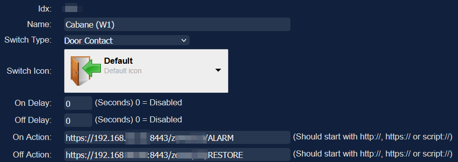

I want to use this door sensor in order to action an alarm system reachable via https.
2025-04-10 15_05_20-Domoticz — Mozilla Firefox.png (22.9 KiB) Viewed 2196 times
I have discovered that the switch configured as "Door sensor" triggers the notifications on every status change, but does not trigger the "On action" or "Off action".
If I set the switch as an on/off standard switch (with a bulb as default icon) instead of a Sensor, when I change the status via the GUI the On and Off actions are successfully called, but when the trigger comes from MQTT, again no action is performed.
(Please note that I have tried both https:// and script:// in Actions, and neither method works)
Is this a defect, or a feature, is there a workaround ?

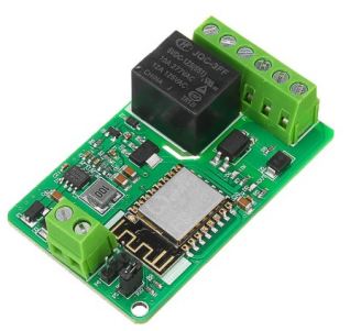

This is the esp8266 module I had purchased years ago: (https://www.banggood.com/Geekcreit-ESP8 ... 36275.html) (https://templates.blakadder.com/geekcreit_10A.html)

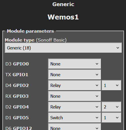

I have uploaded the most recent version of Tasmota 14.5.0
and configured the module as shown:

The module is designed in factory with: GPIO4=output relay , GPIO5=input sensor via optocoupler.
As for many esp8266, GPIO2 drives the status LED on board.
I have thus configured GPIO5 as Switch1 in Tasmota device configuration.
Any change on the door switch generates MQTT messages like
tele/wemos1/SENSOR = {"Time":"2025-04-12T09:53:05","Switch1":"OFF"}
but these messages are not addressed to the Domoticz MQTT queue.
So I have used the feature of Tasmota, linking the input contact to the output #1 (here the blue LED on GPIO2 declared as Relay1), and the LED status change is reported to domoticz/in
Now I understand why Domoticz would not trigger the actions, because it receives a reported status change of a relay. (and not a switchcmd)
I have just discovered your other reply on a similar topic viewtopic.php?t=40656
I will now study how to make scripts within Tasmota.
Thank you a lot for the suggestions.
