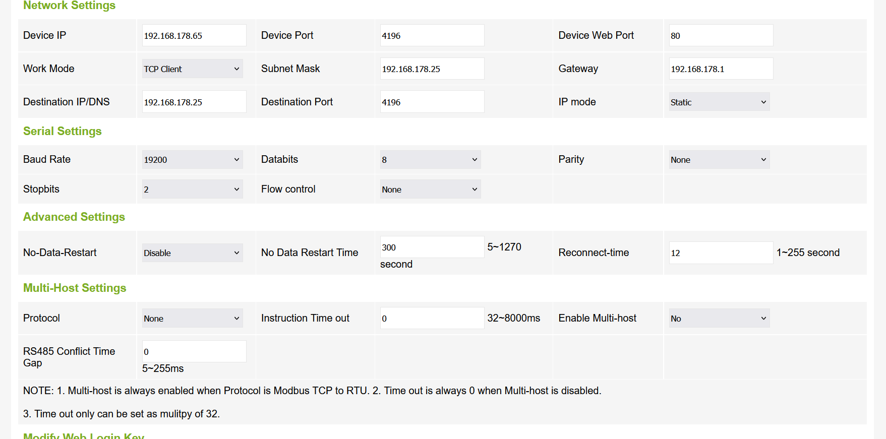

Finally got the plugin running. I'd like to share the settings for a W10 setup using a Waveshare RS485 ETH.
Steps:
Install 32bits version of python (3.9.13) use the advanced option and assure paths are set ok.
Install pymodbus version 3.6.2 using instructions earlier described in this topic.
Do Not Use the newest version 3.7.4 as error messages shown are confusing. See my former post - earlier one is referred to a section how to install pymodbus in windows to avoid problems with path problems. That didnot help.
Configure the WaveShare by logging in on its homepage and use shown settings.
Next post will show the VirCom settings.
Steps:

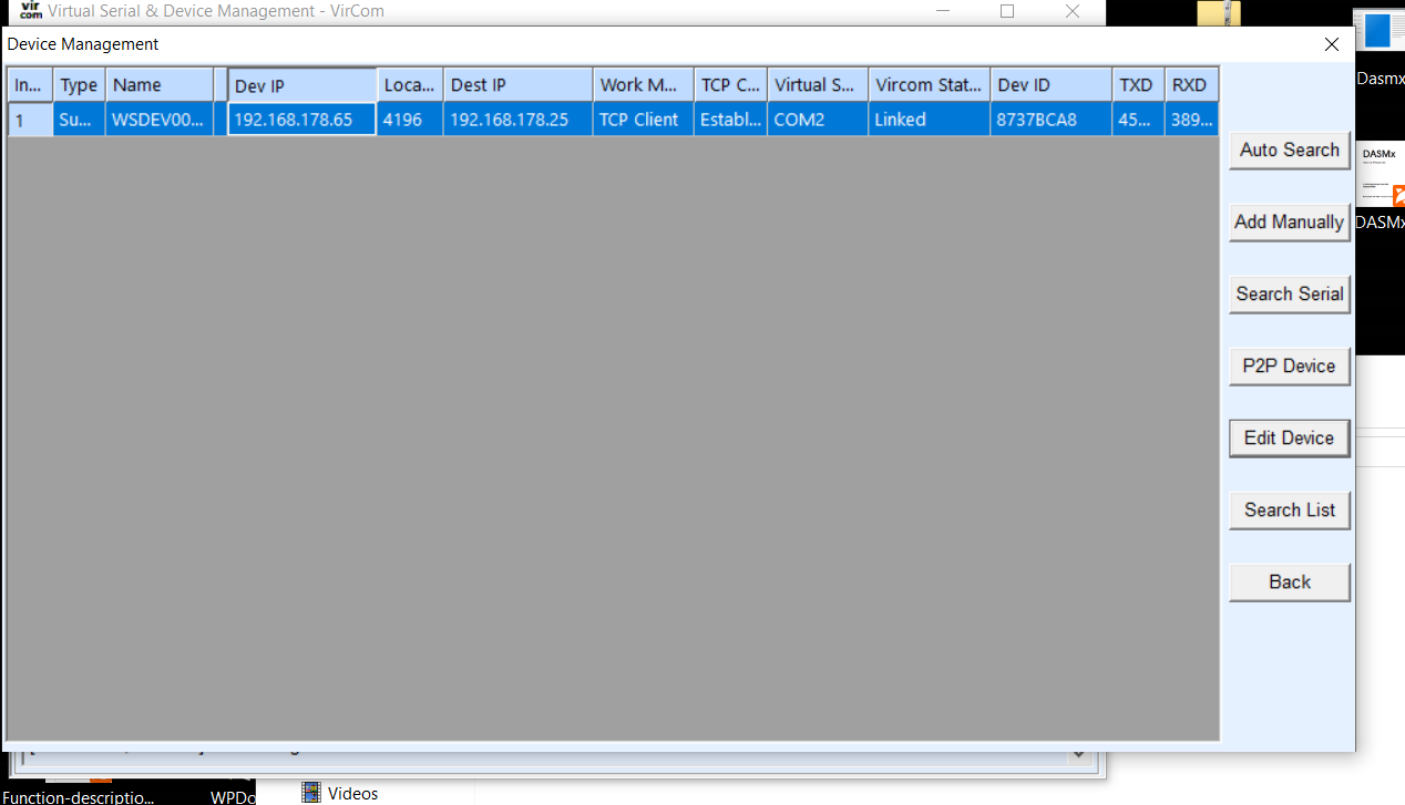

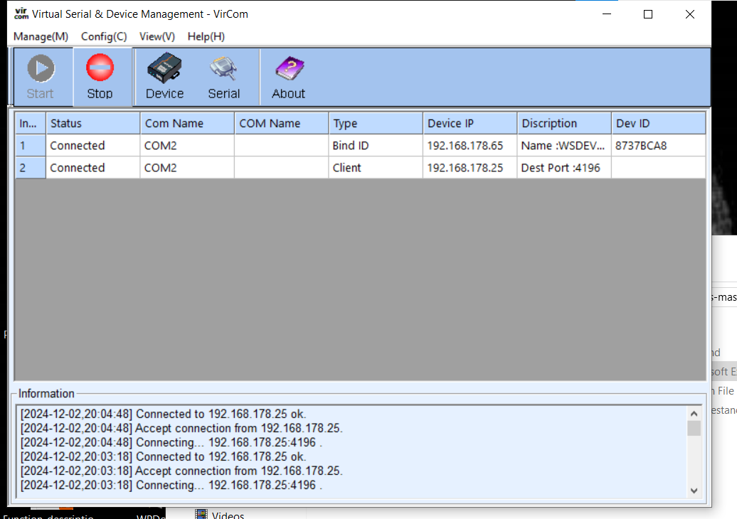

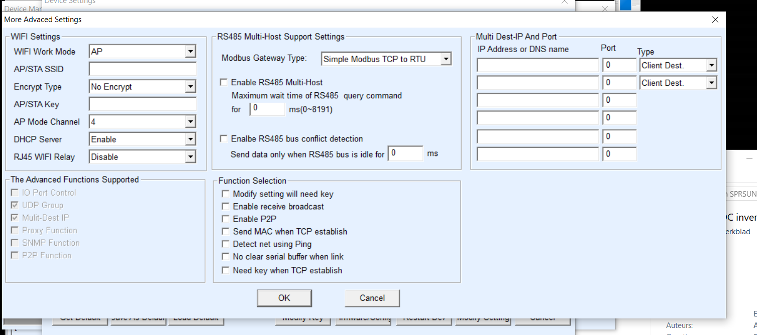

The WaveShare RS485 ETH uses the tool VirCom for configuration. Next snapshots show settings applied. Note it is configured as a TCP client.

And the last one, didn't fit into one post. Hopefully this helps, good luck
