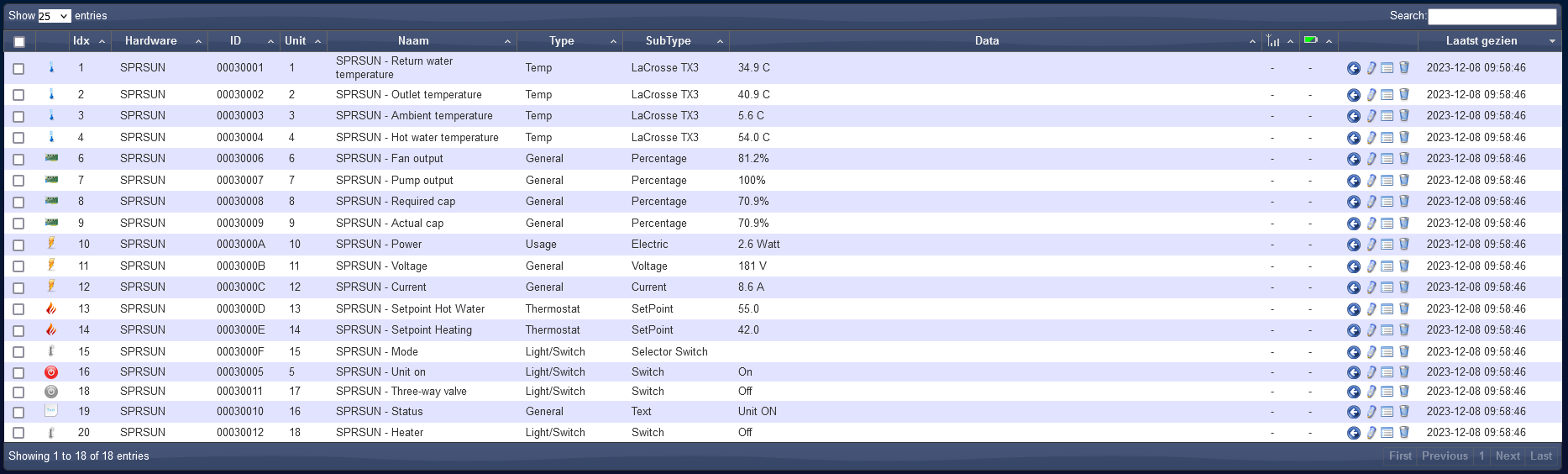

I've made a modbus plugin to read and write some parameters of a SPRSUN heat pump. It can use an USB-RS485 stick or a TCP controller (like ZLAN 5143D)
Please take a look, some refactoring is needed imho (but I'm not a dev on daily basis).
https://github.com/Sateetje/SPRSUN-Modbus
ZLAN Settings:
Serial settings: 19200-8-N-1 (no flow control)
Network settings: Mode = TCP Server
Multi-Master settings: Protocol = None and Multi-Master = Disable
ZLAN Settings:
- Devices
- Screenshot SPRSUN.png (126.92 KiB) Viewed 9942 times
