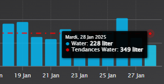

i have a rfx meter counter. Is it possible to get the value 349 tendance water in the dzvents script ?

I believe it is calculated by the highcharts graph module on the webgui part. So not available in dzvents.
You could ofcourse have dzvents calculate a trend based on the values in the database.

As said before, the web graph module highcharts that Domoticz is using is calculating the tendency itself. As input it is using the same raw data from the API calls you now used.
So you have to calculate the tendency yourself with dzvents the same way as the highcharts module is doing.
