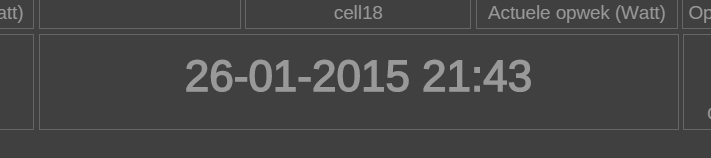

I present the time like this:
May be I need to play a little with the color in the CSS
I fixed a bug in the + when at the lowest level.
