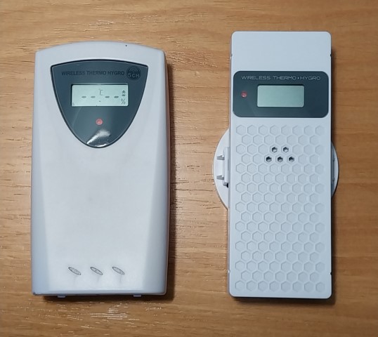

5channel-version from Bresser might be compatible, like
Typenumber: 7009993
EAN: 4007922152097
WEEE-Reg.-Nr. DE 34323861
This device also a candidate:
from TFA offered as replacement for obsolete type 30.3150, modified by Seller for larger range coverage .....
Typenumber: 7009993
EAN: 4007922152097
- 30.3150 and 30.3245.02
- TFA_303150_30324502 [640x480].jpg (52.3 KiB) Viewed 7088 times
Last edited by Toulon7559 on Tuesday 19 November 2024 14:28, edited 4 times in total.
