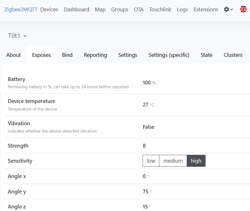

I can see from the ean number that is clearly an Aqara Zigbee sensor.
https://www.zigbee2mqtt.io/devices/DJT1 ... ra-djt11lm
You can update the sensitivity in the Zigbee UI. Before you update the settings, you need to wake up the device by pressing the button on it.
And then change the sensitivity to the desired setting.
