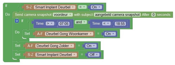

Hi, I'm trying to set up the following blockly.
What is working: doorbell button is pressed (connected to my fibaro smart implant) both chimes ring.
What is not working:
1. the time is ignored for one of the chimes. I expect it shouldn't ring between 18.55h - 07.05h. (I don't want to wake the kids during the night/evening)
2. there is no snapshot sent via email. The log throws an error:
2024-10-29 20:56:17.884 Error: SMTP Mailer: Error sending Email to: <[email protected]> !
2024-10-29 20:56:17.884 Error: libcurl: (56)
2024-10-29 20:56:17.884 Error: Failure when receiving data from the peer
I've setup email in settings and receive notifications normally. I have checked "Snapshots as attachments (Gmail)."
When "Snapshots as attachments (Gmail)" is unchecked I receive the image in alphabetical-format/base64(?) encoded.
I can see the image clearly in Camera settings, it's a Dahua, image URL: cgi-bin/snapshot.cgi?Channel=1
Is there anything I can do on my side? Has someone else the same problem? I haven't set it up on earlier versions of Domoticz, just now.

Thanks for the hint. I just did that, unfortunately the same error pops up in the Log, so it doesn't seem to be a Blockly issue..waltervl wrote: ↑Wednesday 30 October 2024 14:49 Then it seems perhaps an issue with blocky. I don't use that.
