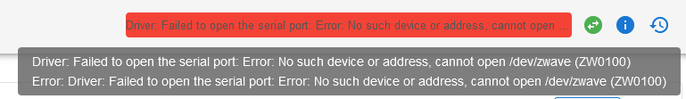

Same problem for me:
Failed to open serial port
cannot open *dev/zwave(ZW0100)
Here is the zwave-js-ui screenshot: I followed: https://www.domoticz.com/wiki/Zwave-JS-UI
I am on Synology DS420+ DSM 7.2
Debian Bullseye on virtual machine manager
zstick gen5 updated to EUV1.02
Here is my docker-compose.yaml:
I don't understand what solve remko2000's problem:

I found a problem on my config:
This can be a bug on Debian 11 Bullseye:
https://klipper.discourse.group/t/debia ... ound/10711
So I upgraded to Debian 12 Bookworm:
https://www.malekal.com/mettre-a-jour-d ... debian-12/
After upgrade and reboot, I have /dev/serial/by-id/ but after zwave-js-ui restart, it is lost again.
Here is the trace:
The synology virtual machine reboot does not solve the problem but with synology DSM reboot ls /dev/serial/by-id/ exist again!
ben@domoticz-nas:/opt/zwavejs-ui$ ls /dev/serial/by-id/
ls: impossible d'accéder à '/dev/serial/by-id/': Aucun fichier ou dossier de ce typehttps://klipper.discourse.group/t/debia ... ound/10711
Here is the trace:
ben@domoticz-nas:~$ ls /dev/serial/by-id/
usb-0658_0200-if00
ben@domoticz-nas:~$ cd /opt/zwavejs-ui
ben@domoticz-nas:/opt/zwavejs-ui$ docker compose up -d
[+] Running 2/2
✔ Network zwavejs-ui_default Created 0.3s
✔ Container zwave-js-ui Started 0.3s

devices: /dev/TTYACM0:/dev/zwave" in the .ymlI tried another option: I installed debian12 from scratch with only qemu (tools for synology) and z-wave-js-ui (and no domoticz)
No luck:
- z-wave-js-ui still fail to open serial port
- ls /dev/serial/by-id/ lose serial after zwave-js-ui start and some time
- I must umount + mount zstick in the synology virtual machine to get again usb-0658_0200-if00 from ls /dev/serial/by-id/
Is there something wrong with synology DSM7.2+Debian11-12+zwave-js-ui or something wrong in my zwave-js-ui install?
Domoticz V2024.7

7 month later: I found the problem for myself.benp wrote: Thursday 11 January 2024 16:18 Hello,
In zwave-js-ui / settings/ zwave , I disable soft reset and it works. I used the snap method explained in the french forum:
https://easydomoticz.com/forum/viewtopic.php?t=13522
But both docker and snap produced the "failed to open serial port" so I suppose the disable soft reset solve both method.
