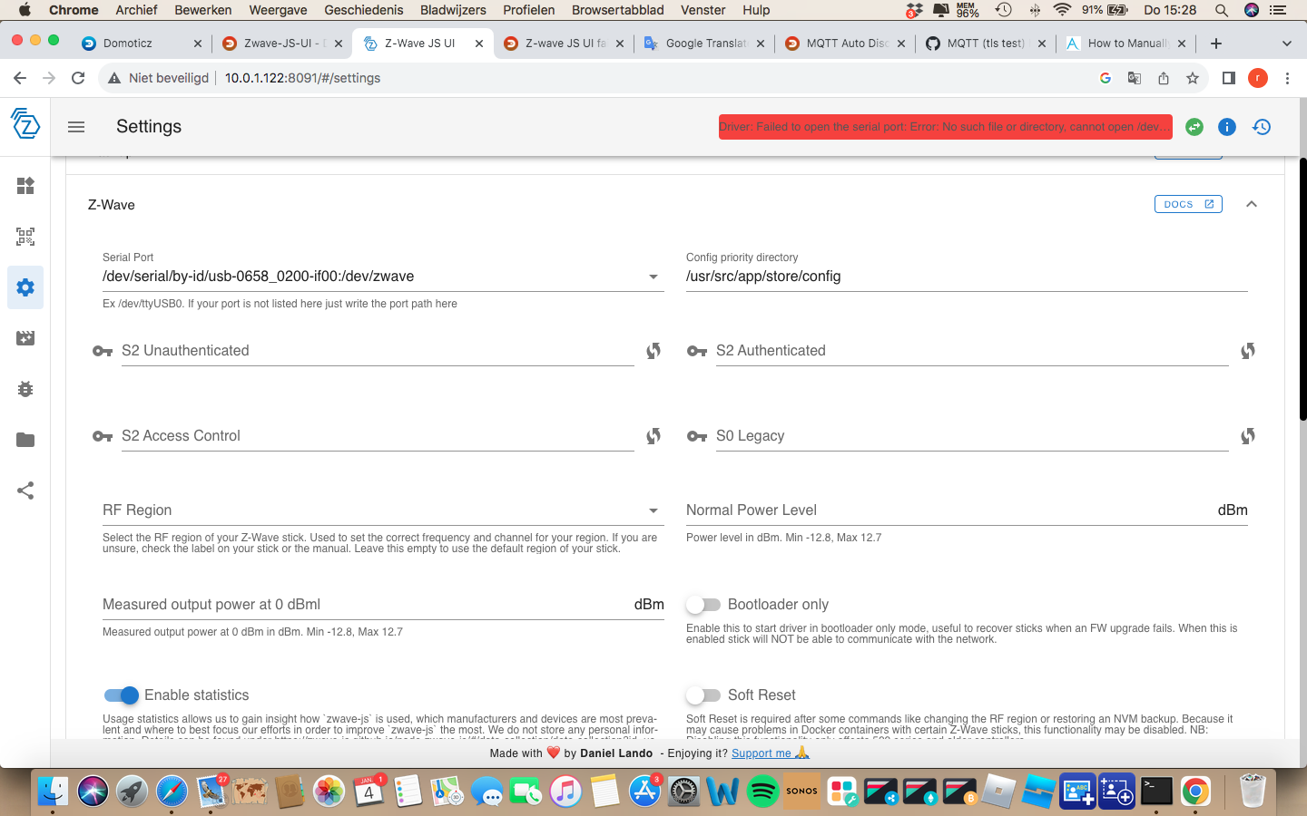

Hai there. I followed:
https://www.domoticz.com/wiki/Zwave-JS-UI to pass form OZW to Zwave JS UI.
I am now ready to open JS UI' s user interface.
I do al the recommended settings but I get the error in Z-wave JS UI:
driver: failed to open the serial port: error : no such file or directory, cannot open /dev/serial/by-id/usb-0658_0200-if00:/dev/zwave (ZW0100)
Schermafbeelding 2024-01-04 om 15.28.52.png (305.12 KiB) Viewed 49237 times

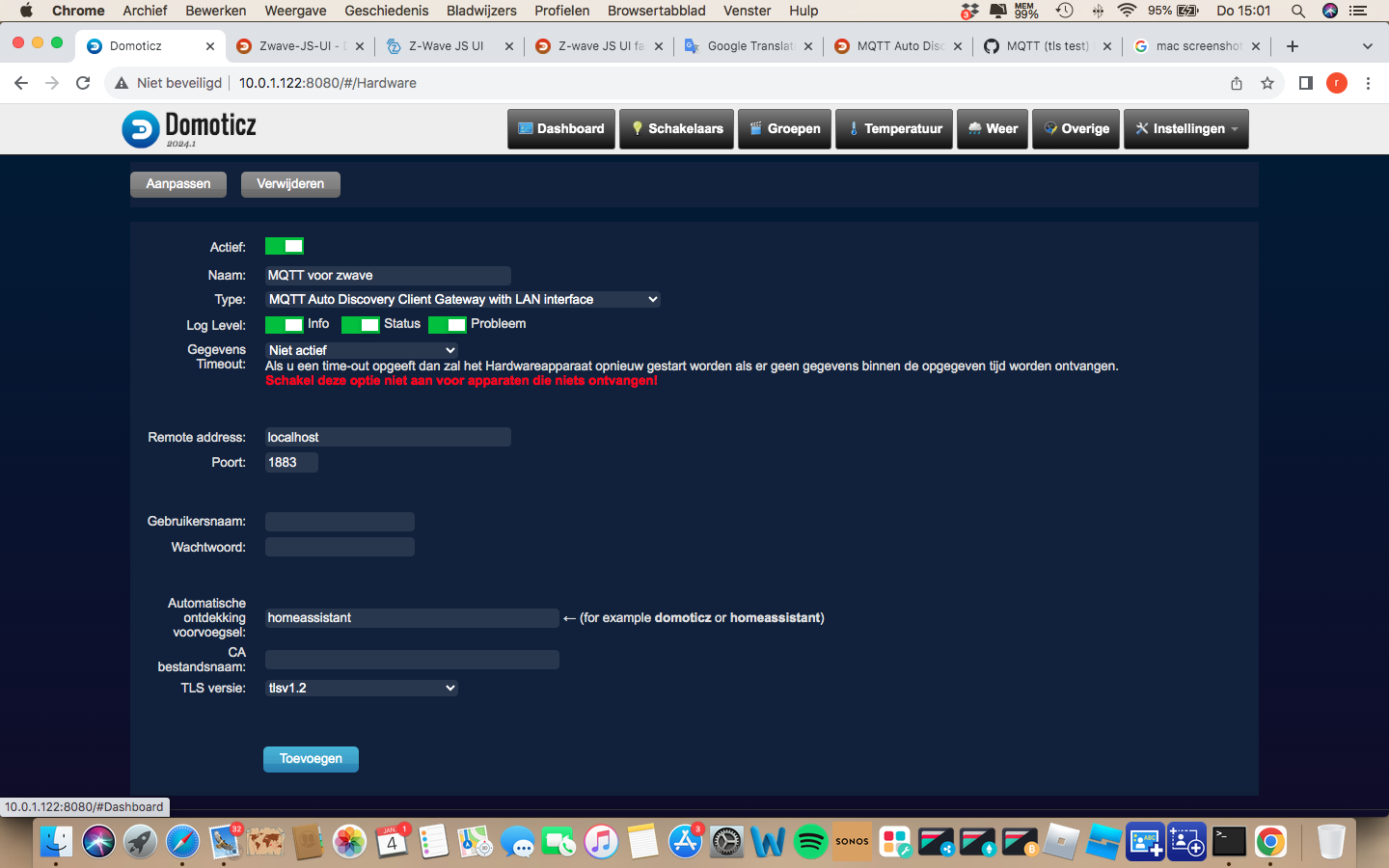

In domoticz I get also an error in my log:
2024-01-03 18:47:26.148 Error: MQTT Auto Discovery Client Gateway with LAN interface: Failed to start, return code: 14/Connection refused (Check IP/Port)
Schermafbeelding 2024-01-04 om 15.01.12.png (304.72 KiB) Viewed 49243 times

in the field “Serial Port” of your zwave JS (the one on port 8091/#/settings), there you should only put ”/dev/zwave”
the docker compose file tells to map external (out of docker) usb device by ID to internal (where zwave js runs) /dev/zwave

Are you sure your device ID is correct and it is not: usb-0658_0200-if00 (without the port0 part)
My docker-compose.yml file in root@homebridge:~/mosquitto-docker-compose# looks like this:
Is this a typo? Or do you zwave-js and mosquitto in the same directory?

This seems the right response as I have the same device and in my working zwave-js-ui it is

Tried it and fill ' /dev/serial/by-id/usb-0658_0200-if00' in in the zwave js ui. Still the same error.............

remko2000 wrote: Friday 05 January 2024 11:13 Tried it and fill ' /dev/serial/by-id/usb-0658_0200-if00' in in the zwave js ui. Still the same error.............
should be in your docker compose file in the ports section
/dev/zwave should be in you zwave js ui

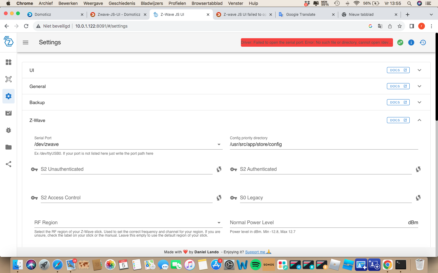

I' confused:
In my zwave js ui I set '/dev/zwave' :
I also checked my docker-compose.yaml file. The strange thing is that I have two of these docker-compose.yaml files.
One in
map ‘mosquitto-docker-compose’ (root@homebridge:~# mosquitto-docker-compose)
the other in
map ‘zwavejs-ui’ (root@homebridge:/opt/zwavejs-ui#)
They now both contain the same content:

However, I still get the same error (even after a reboot). Is it normal I have two of these files or did I make a mistake with the installation? I'm not very proficient in Linux.

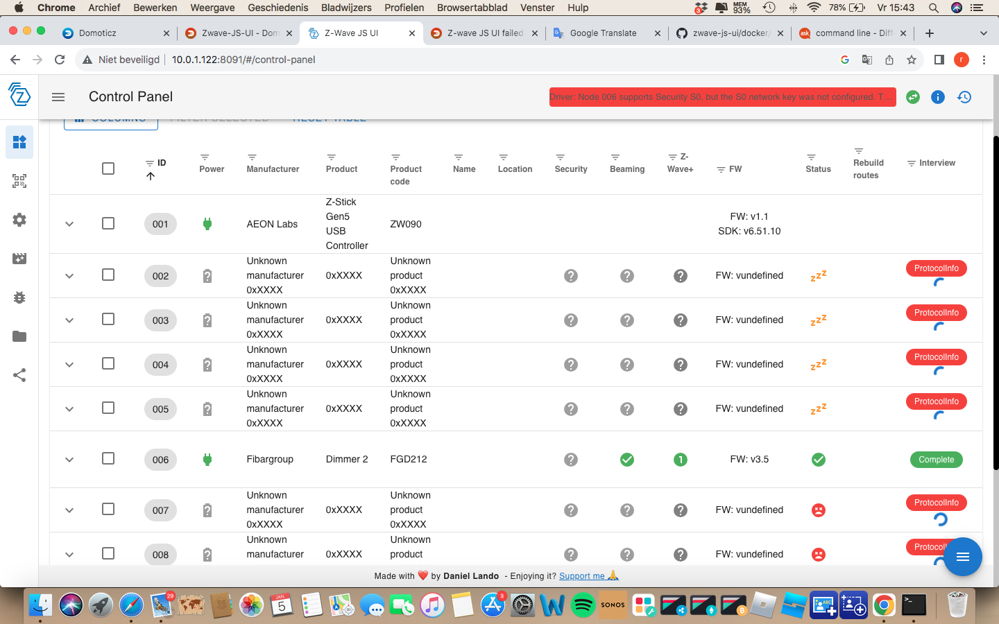

after many trial and error I tried again:
' docker compose up -d'
after recomposing zwave js ui, I see zwave devices in my control panel:
I think this is ok.
However, the mqt error in domoticz remains:
Error: MQTT: Failed to start, return code: 14/Connection refused (Check IP/Port)
what could I have done wrong when installing mqqt and how could I fix it?

No that's not correct. Please follow the (updated) domoticz wiki about migrating to zwavejs.
There the steps are explained correctly how to install mosquitto
After you install it, test with MQTT Explorer to see if you can connect to it
You should enter the IP address of the machine, not localhost !!!
also not 127.0.0.1, but the IP address the of machine (like 192.168.30.40) or the IP address of the mosquitto docker (each docker gets a unique IP address), but you should use the machine's IP address

In domoticz I do use localhost with the mqqt auto discovery hardware.
In zwave-JS UI I have now set the IP of my machine instead of localhost. I am now indeed receiving zwave hardware devices.
